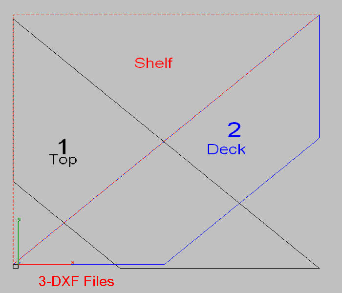

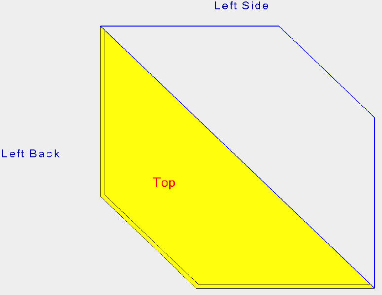

Re: Angled Cabinet
Angled Cabinet
DXF Files_Deck,Top,Shelf
I set them up in a Cad program and save the DXF File in e-Cabinets
I hope this helps you John
DXF Files.zip
(44.21 KiB) Downloaded 1333 times
