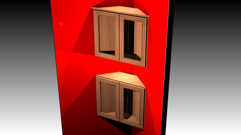

Does anybody know how to create a cabinet with angled sides?

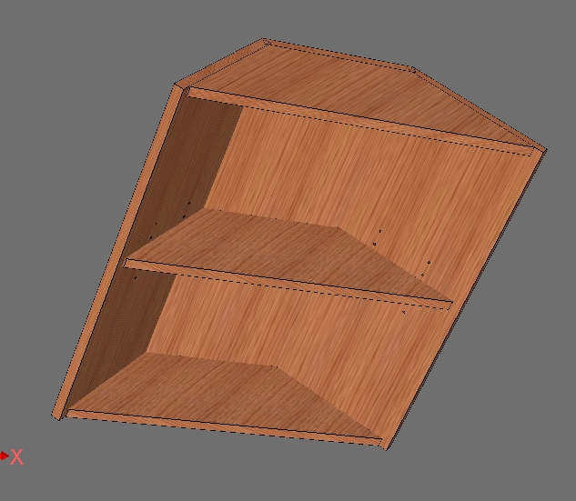

John,
You will need to build it from a corner cabinet. I have attached a cabinet and i can walk you through it if you need.
- Attachments
- angle.hsf
- (138.02 KiB) Downloaded 1178 times

John,
This is a view of the front of the cabinet. You can extend the two ends in length so that you can miter them but eCabinets will not show that graphically.
What is the issue for moldings.

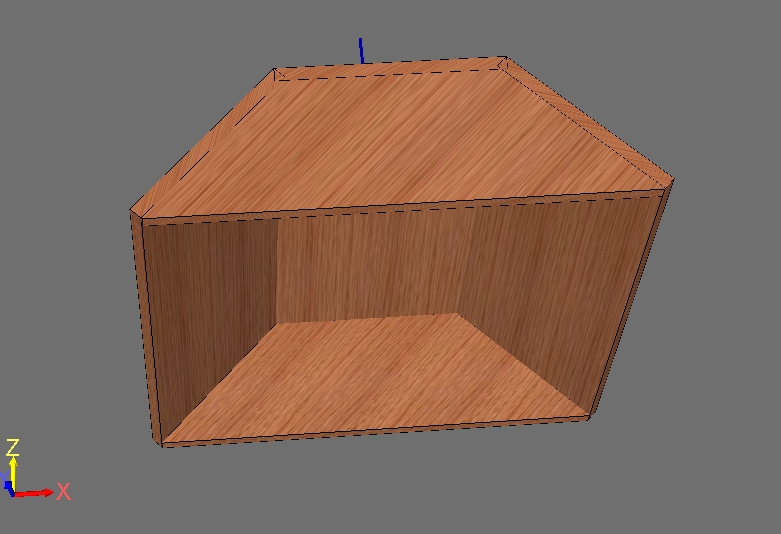

Re: Angled Cabinet
Angled Cabinet
- Attachments
- Corner Cabinets_12-24-11.esj
- (1.09 MiB) Downloaded 1178 times

Kerry,
The cabinet you created looks good, see attached results when I put a fixed in the cabinet.
How do I get around that?
John
John

Re: Angled Cabinet
John,
I don't get that result when I add a fixed shelf. My fixed shelf looks like the adjustable shelf I posted above.
I have to use some tricks to get the cabinet you want from the corner cabinet.
In the cabinet I posted I have turned off the left and right ends. To add shelves I must turn the ends on, add the shelves and then turn the ends back off.
You probably won't ber able to adjust any dimensions or make changes to the cabinet without turning the ends on.
We are doing some things this cabinet was not designed to do.
I haven't looked at Georges cabinets to see if he had some better ideas. When I get back to the office Friday I will play with this some more. Right now I am working on a netbook using stolen internet so it is hard to experiment.

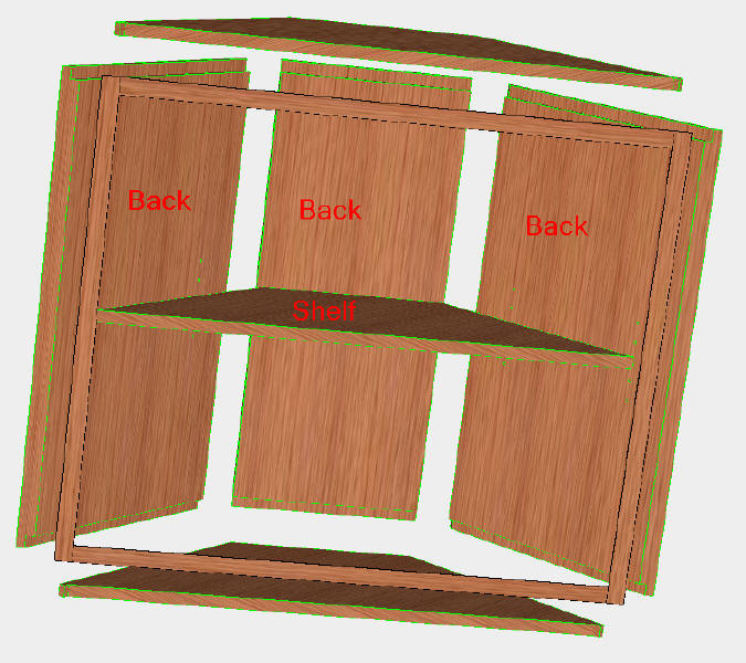

- George Davidson
- Posts: 1585
- Location: Norwood Pa.
Re: Angled Cabinet
Angled Cabinet
- Attachments
- Corner Cabinet with Shelf 12-27-11.esa
- (778.02 KiB) Downloaded 1191 times

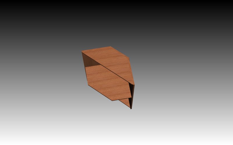

- George Davidson
- Posts: 1585
Re: Angled Cabinet
Angled Cabinet
DXF Files_Deck,Top,Shelf
I set them up in a Cad program and save the DXF File in e-Cabinets
I hope this helps you John
