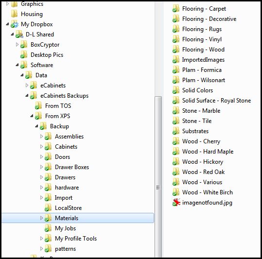

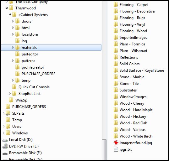

I just did a backup & noticed that it did not include everything in my 'Materials' folder. It's missing 2 folders ('Reflections' and 'Window Images' [and all their contents]) & 1 file ('jpgs.txt'). Can anyone please explain why?

Now I can't even get a Conestoga door to have a woodgrain image applied to it (image not found). I can understand that it can't find the file because I've moved/renamed them, but I can't find how to change the location of the image file in the door editor. How do you do it?
Are all users of eCabinets condemned to using the existing filenames & folder hierarchy that it comes with?

The standard cabinets, doors and drawer fronts are linked to specific files from a specific path. If you move or remove those files, then you will get the "texture not found" message or a yellow image tile that looks like construction zone tape or sign. The materials and finishes for these can only be changed from files located in the default paths. The Conestoga Doors and Drawers were previously sold through our online store. The materials and finishes are those that are specifically available through Conestoga and thus are limited to those offerings from those folders. Finishes for other door and drawer types can be selected from any other folder in the Materials dialog, but the material originates from a Generic material for sheet and banding stock.
I advised not to remove the Generic materials for sheet stock, banding stock and banding stock. Also, I mentioned specifically, not removing or relocating the Brewster (wallpaper) folders as removal of the default folders does and has caused problems. The key to the latter is not to remove or rename default folders. I mentioned the Brewster folders as there are a lot of folders that are alphabetically first in the Materials folder and there has been an inclination to move or remove those. Someone in the past did specifically remove or reorganize those folders and it did cause problems. Previously, I hadn't talked to anyone that had entirely changed the folders for the various wood materials, so it did not come to mind during our conversation yesterday and the bulk of our conversation was about backup.

Gary: I look forward to the day when I have a better "big picture" of how eCabinets functions. Obviously, knowing all of its idiosyncrasies (like these that I've already experienced) is crucial. I may be a bit different than most users in that I like to have a thorough understanding of how things are built, from the ground up. Hence my desire to cleanup the materials library. I'll try to remember your advice. Thank you.
Dennis: Obviously I'm not the first user that finds the materials folder (which is actually just images) a total mess. I have never worked with software that didn't allow some kind of restructuring of a user-edited directory. You have not told me where the Conestoga doors get their images from, so along with the other problems associated with moving/renaming files, I can see that eCabinets is not configured for user changes in this fashion (as you tried to tell me before - sometimes I'm a little thick headed). I am surprised though that you do not sound interested in taking this as a suggestion/opportunity to improve the product.
Therefor, I have decided to change my tact a little on this. Rather than trying to remove & rename existing files & folders I'm going to do like brewster did - add my own. I have reinstated the complete original materials folder & I will now take copies of all those images that I want to use & place them in my own folders - at the top of the list - in a way & naming convention that I find useful.
I hope that someday eCabinets will have the ability to cull, revise, merge the contents of this folder so that I can get rid of all the unused files & folders in there.
As far as the actual materials in the library go, I think I'll do the same thing: Keep all of the default eCabinets materials as is (ie: Generic materials & those added by others' downloaded libraries) & then add my own materials to the start of the list with a prefixed symbol that brings them to the top of the list. Do you see any problems with this?
