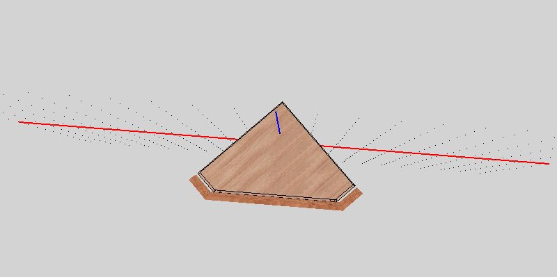

Can someone tell me why the side crown molding will not go against that cabinet? I have noticed this for awhile and wondered why this happens.

John,
It is from the negative 3/4" scribe on your face frame.
