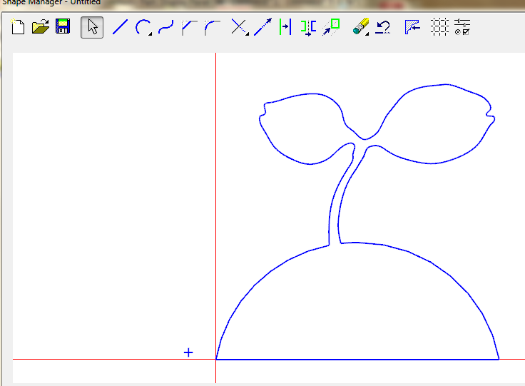

Dennis Englert
Re: Part editor trouble with DXF again
Using the techniques I described in the page that I attached, I had a workable version of the geometry. I've attached to images to show it in the Shape Manager and the Part Editor.
The scale appeared to be way off. I was in Inches and Decimal and it came in very, very small.
Dennis
Dennis
Dennis Englert
I've gone in and looked at the scale on the dxf file. I'm not sure why it is coming in extremely small, like 1/4 scale. Maybe someone else has a clue. I'll continue to look.
