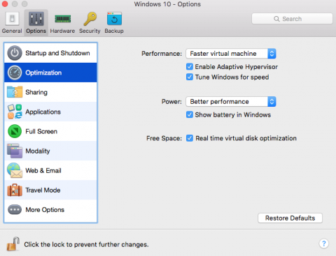

Have you uninstalled the old parallels tools and installed the newer version of parallels tools?
Did you make sure to set the power option to better proformance?
http://kb.parallels.com/en/112476

I mostly have it set to better performance as shown in the link. But as far as enabling the 3D Acceleration in the link you sent, there is no longer just a check box to enable 3D Acceleration. There is a drop-down box with the options Disable, DirectX9, or DirectX10. That is what has got me confused. Do you know what option I should be selecting there?

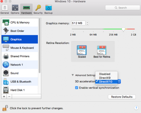

I tried un installing and re-installing Parallels Tools and there was no change. I added a screenshot of my available selections for 3D Acceleration. Do you have any ideas?

I think it should be directx 10 since it is windows 10. Can you make sure that parallels is using the discrete video card?

To switch between the adapters, go to virtual machine configuration window -> Options -> Optimization - Power
For integrated graphics (CPU) set 'Longer battery life'
For discrete video card set 'Better performance'

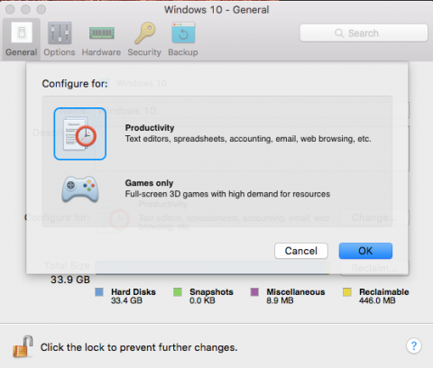

Another thing to try is swapping to Games Only or Design Profile.
http://kb.parallels.com/122658

I did have it set to 'Better Performance' so it should be using the discrete. I get the exact same performance no matter if it is set to 'Longer Battery Life' of 'Better Performance'. That is, if 3D Acceleration is disabled, it will draw but extremely slow. With either DiscreteX enabled, it does not draw at all.
I also tried the gaming mode which didn't change the way eCabinets performs.
Interestingly, there no longer seems to be a 'Design' profile.
