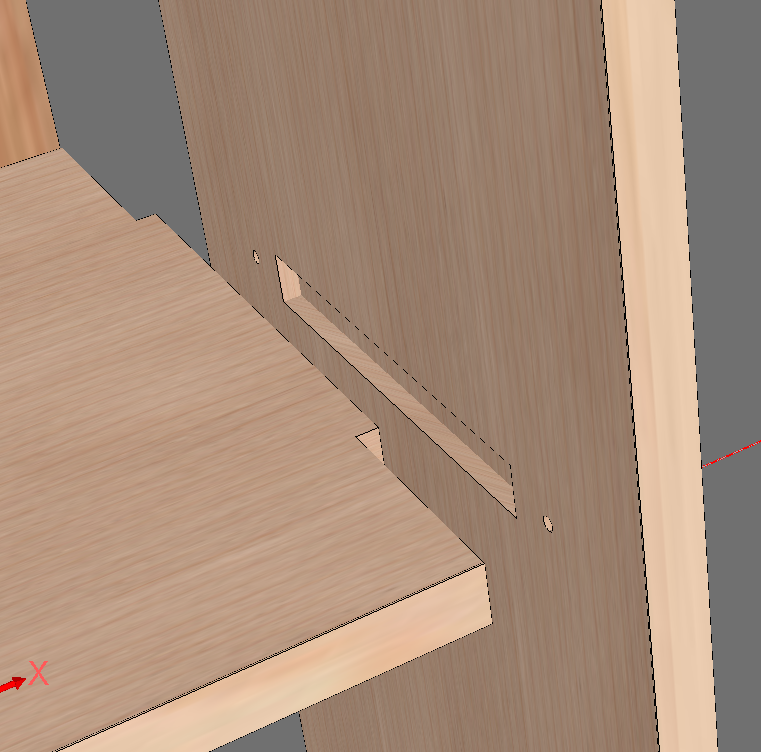

If this is what you're after, all you do is use a lock dado, and set the tenon thickness to 100%. Works great, we use it all the time.

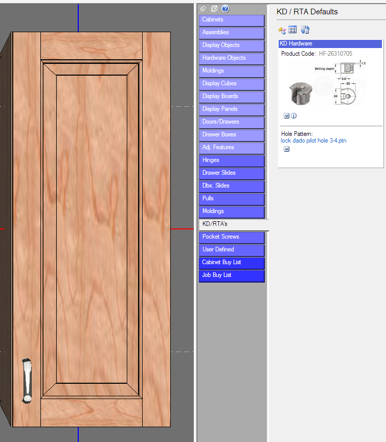

The pilot holes are actually custom KD/RTA hole patterns, because when you choose Lock Dado as a joinery method, it wants to use KD/RTA fasteners and their associated hole patterns. So, you just make a "pattern" that is a single hole, get rid of the hardware, and voila.
I've uploaded our patterns so you can see. Change the file extension from .txt to .ptn of course.

I use a modified kd pattern starting with the hafele model which is default. When I rename and save it the file type is applied by the software as it should be. I have attached a recent project that I did for a local business and used locked dados with my modified pattern. One other thing I will mention. THe 5mm hole which is drilled for the KD pins is not on the center of the work nor does it drill right through to the other side of the material. I have created a pattern for both 5/8 material and 3/4 material and set the depth so that the whole drills through the material but not too deep into the spoil board. I relocated the center of the 5mm hole to center on 5/8 and 3/4 in there respective patterns.I use this pattern when I want to drill pilot holes for conformat screw assembly. You do not have to use full width dados and tenons. you can keep the blind dado setting and adjust the lock dado tenon gap in construction settings to suit your preferences when designing your cabinet.
