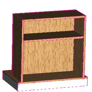

Normally I can work thru the glitches. Never used opening locks on this cabinet. So thats not what caused it. Cannot select or delete the shelf. Ive worked backwards and put the cabinet back to a normal cabinet but still whatever the issue is is still there. Can anyone else delete it?

Initially I could not, but I found that zooming in on the cabinet for some reason enabled me to grab the shelf.

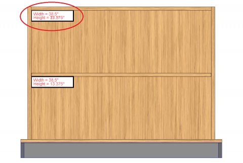

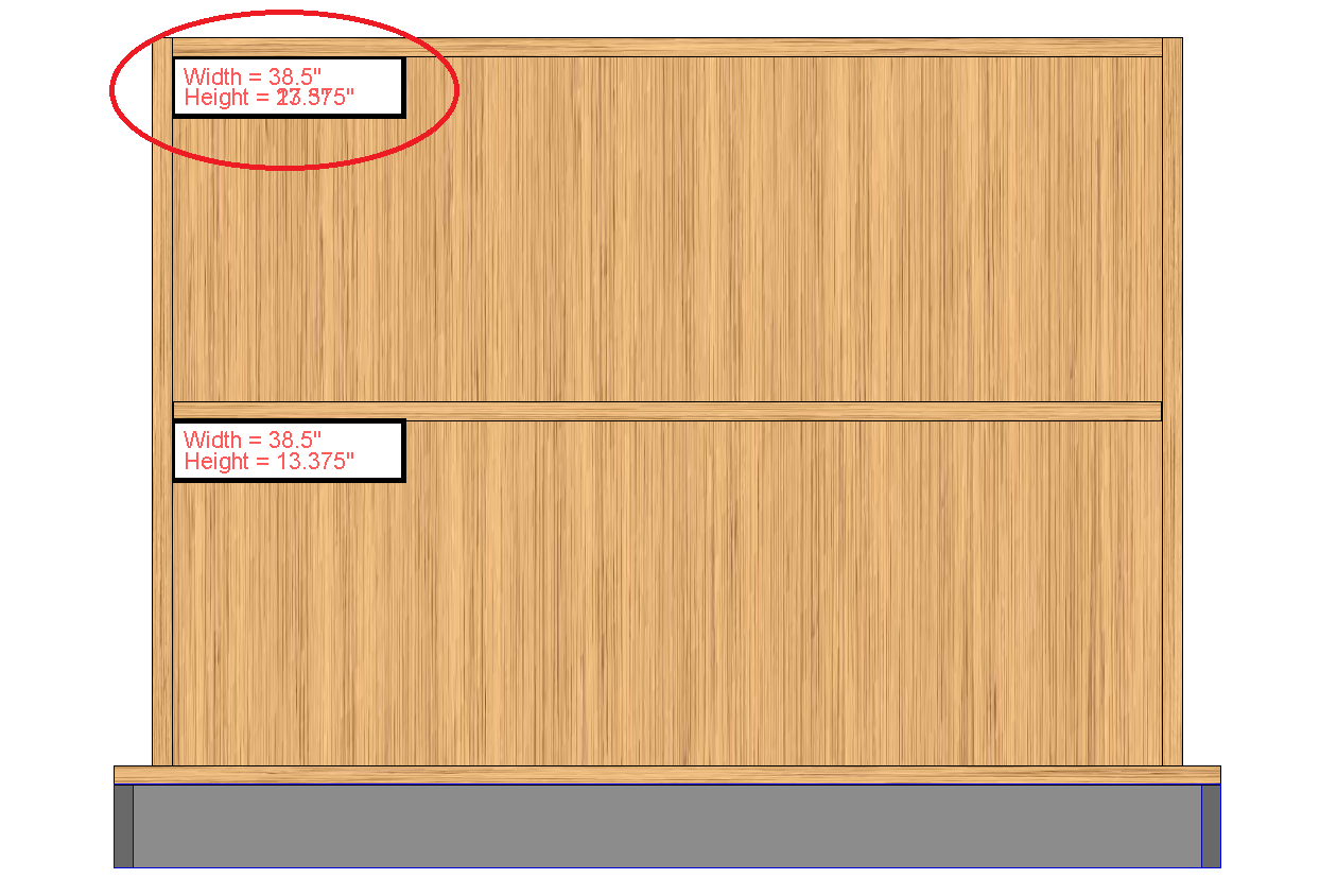

That also worked for me. I was able to delete the shelf. Now when I re-add it, ecabs does the same thing as before. I can see the top opening is showing 2 dimensions overtop of each other.

I did try to delete the shelf and I could not get it to highlight in the shelf editor so I could do nothing with it. I was able to highlight it in the main area of the cabinet editor but was not able to delete it. I was redirected to use the appropriate editor to delete the shelf. I was also able to highlight the shelf in the stretcher editor but again could not delete or do anything with it. I got a message about only highlighting one item at a time when I was in the stretcher editor. I thought this to be odd because there was no indication that anything else was highlighted.
