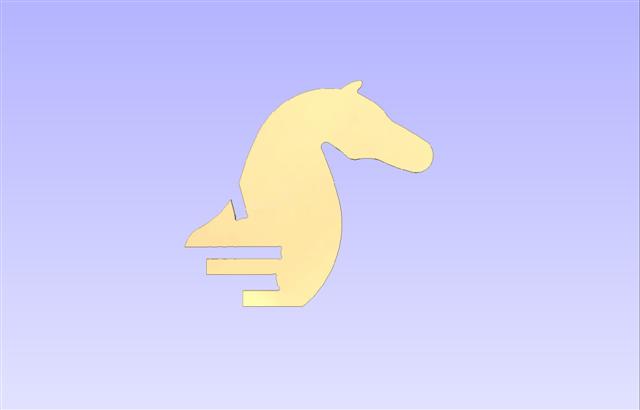

I did a node edit to look at the detail and it has 53 nodes. This is not a special file that I need to cut. Just one I picked at random to try a test. There are some bezier curves in it.It has dog bone cuts on the inside corners of the slots. This is just one of the pieces of a rocking horse. It all cuts out of 1/2 sheet of ply so this part is about 18 inches tall.

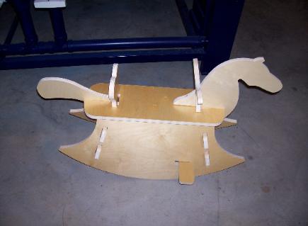

FYI, It is just the head to this rocking horse. If anyone wants the full dxf I will pass it along free. It makes a great gift and can be taken back apart when the child outgrows it.

In the CAD program you are using, explode the horses head into its basic components. It's one line now. Once I did that, it worked fine in eCabs.
