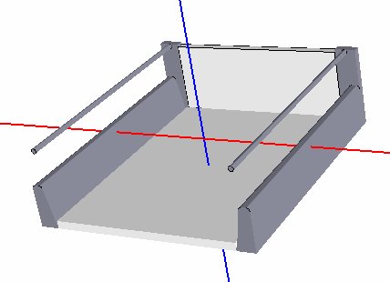

See what I mean Drawer box Editor is awesome, Just need some holes in the back of the drawer fronts

Sean, That is awesome and you even edgeband the drawer bottom at the front. All we need is a little plate where the adjustment screws are with "Sean's cabinets"

Re: Drawer Slide Front Mounting Hole - Incorrect Orientation
Thats awesome, how did you do that? I assume profile cuts?Sean Jakob wrote:See what I mean Drawer box Editor is awesome, Just need some holes in the back of the drawer fronts
Bryan
- I Created a sheet material called DONT cut - which was approx 30mm thick
- used that material for the drawer box sides
- Ensured that the insets of the left and right side were set so as to attain the side size the overall width, length and height required to totally encompanss the entire part (including the gallery rail)
- created a Tool (weird shape
- Drew a contour line along one edge (Stopping 16mm short of the end of the side)
- applied the profile cut to that contour line
