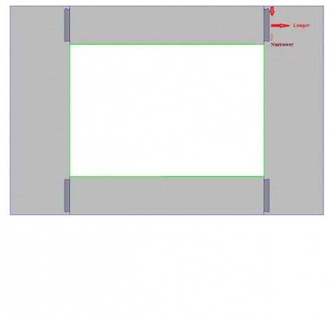

Can the puzzle joint be modified to make the puzzle part longer and narrower? I have a face frame that is about 45 wide and 25 high. The stiles are 8.56" wide and the rails are 5.5" wide (Per customers drawings). The current settings make it to short for this size parts. I would like to make them at least 25-50% of the width of the stiles and rails so there is more glue area and support. Can this be done?

The only control over puzzle joint settings that an operator would have is under: Construction Settings>Face Frames>Face Frame Construction Parameters>Puzzle Joint Settings. This allows operator to work with Thickness, Depth Clearance and Fit Clearance of given puzzle joint.
