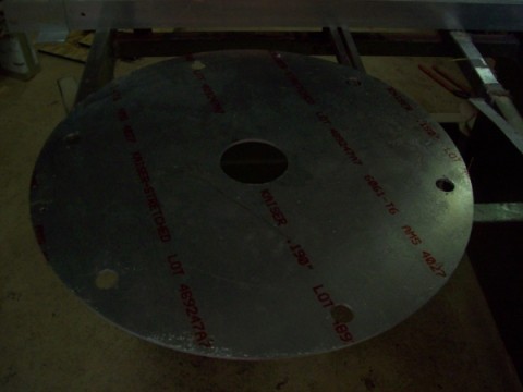

Here is some 1/4" 6061 sheet we cut last year for a project. We used a Onsrud spiral o-flute upcut. It took a while to get all the feeds and speeds down but after we did it cut like butter.
PS. We drilled all the holes first and then ran screws in to secure the piece to the wasteboard. We also squirted a small amount of cutting fluid at first, but it didn't seem to make that big of a difference so we stopped on the last few sheets.
