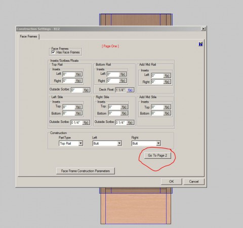

go into face frames and then
consturction settings then into page 2

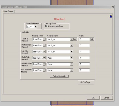

now you can select differant material for your stiles and set the width as you want

Doesn't work. As soon as you switch to another thickness it populates the field with that thickness wood and you lose the side stile thicker wood.

Leo Graywacz wrote:Doesn't work. As soon as you switch to another thickness it populates the field with that thickness wood and you lose the side stile thicker wood.
If you click ALL it will populate ALL to the same thickness otherwise you can set each one individually

As soon as I click on another thickness it populates it with the first species in the list with that thickness.

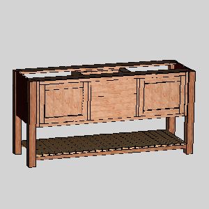

Here you go Leo. I did this for a customer very recently. All done in eCabs.
Master vanity.jpg (15.16 KiB) Viewed 19121 times

The legs are a display board. Anyone can do that. 8)

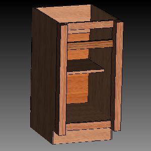

Try this work around. Design your cabinet with the thick stiles, delete top bottom and mid rails. On page 2 of face frames change add mid rail to your thinner thickness material and add them to the cabinet to replace the rails you deleted.
2 thickness frame.JPG (12.54 KiB) Viewed 19057 times
