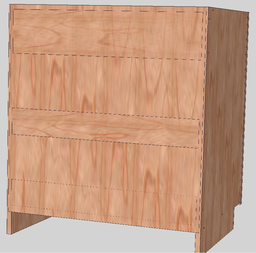

Thank you for the reply Carmen.
When I set the stretcher to inset 0, then go into advanced and set inset to "Back", I get what's pictured below. It seems the inset is not taking or I'm doing something wrong. I've regenerated the cabinet and still have stretchers not inset.

Postby Donald Thomson » Mon, Aug 20 2018, 3:40PM
Here's a close up of what it appears to be doing to the stretcher. Even though I set the inset to be the "Front" of the "Back" in advanced settings, the stretcher seems to be getting a 0 inset value as evidenced by the attached graphic.
I must be doing something wrong, or this isn't working as expected.

Don,
I opened your cabinet and saw each stretcher had a -.2" inset for the inset relative to the back. When you set a stretcher relative to another part, you need to readjust the inset value back to zero. If your's each show zero, try restarting your computer and eCabinets to make sure nothing is hanging on to something it shouldn't be.

Clint,
Must be a bug in eCabs. Restarted eCabs (not computer), reset the adjustments on the stretchers and all is good now. eCabs is not redrawing or recalculating something properly when using the advanced stretcher settings.
