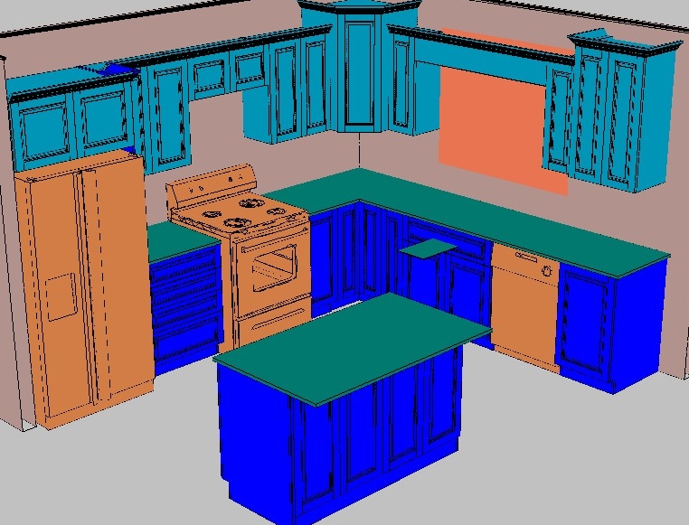

Here is a short description of something funny going on since 5.2 (build 1)
After countertops have been added to a kitchen...when editing a cabinet in the cabinet editor, after exiting the editor a new piece of 'countertop' is appearing protruding from my sink cabinet. I can not delete this piece, or the main countertop that it appears to be associated with. I have to reload the last saved layout that did not have this issue, and redo what ever work was done since that point. I have had it happen a few time with this layout, after editing differant cabinets...all though the 'new' countertop seems to appear in the same place. Attached is a pic and the kitchen file for your inspection.

Mark
I loaded your job and went to the counter editor. I double clicked on the counter top and click on delete counter top at the left hand side. I added the new counter top and everything seems to be fine. Here is the job file. If this still happens please let me know.
