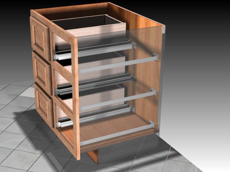

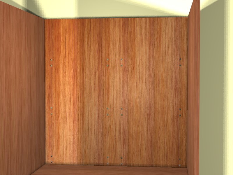

Re: Drw Guides

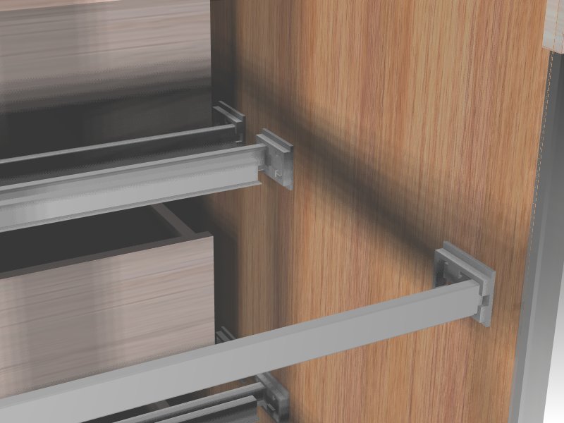

Drw Guides
- Attachments
- Drawer runners_1.jpg (67.49 KiB) Viewed 9498 times
- Drawer runners_2.jpg (58.93 KiB) Viewed 9497 times
- Drawer runners_4.jpg (74.06 KiB) Viewed 9497 times

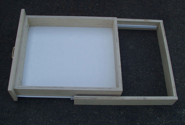

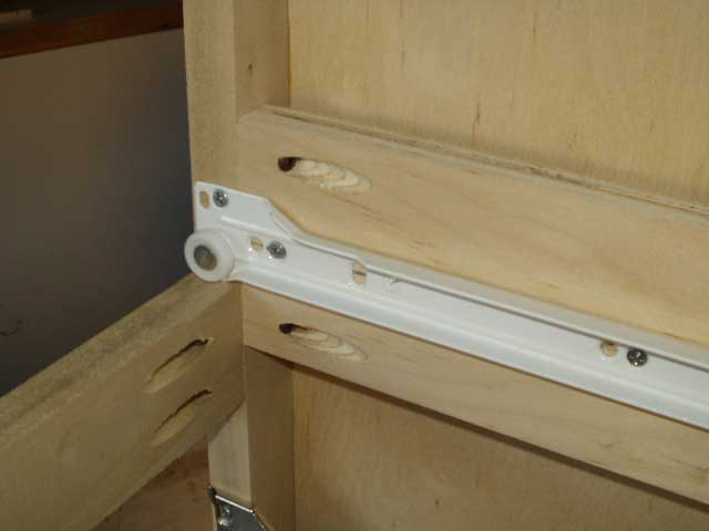

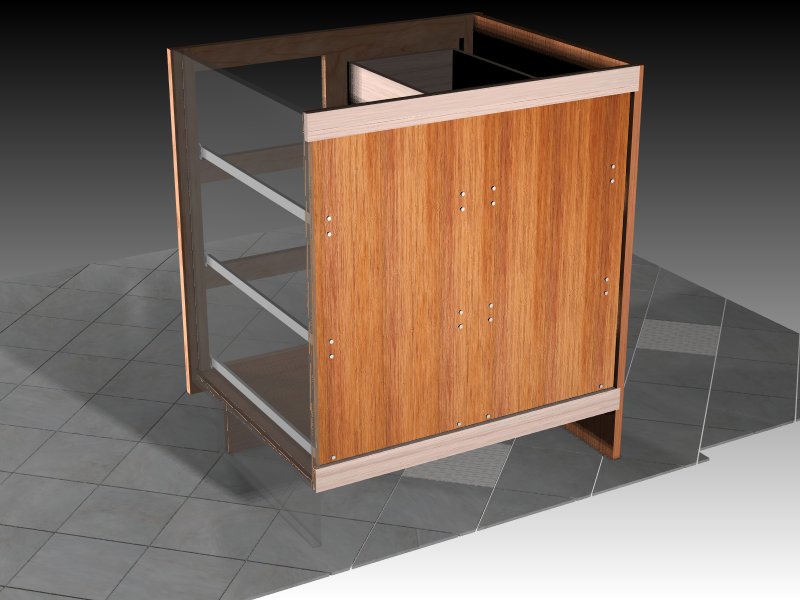

Re: Drw Guides
Drw Guides
- Attachments
- Drawer runners_5.jpg (49.22 KiB) Viewed 9492 times
- Drawer runners_3.jpg (60.62 KiB) Viewed 9492 times

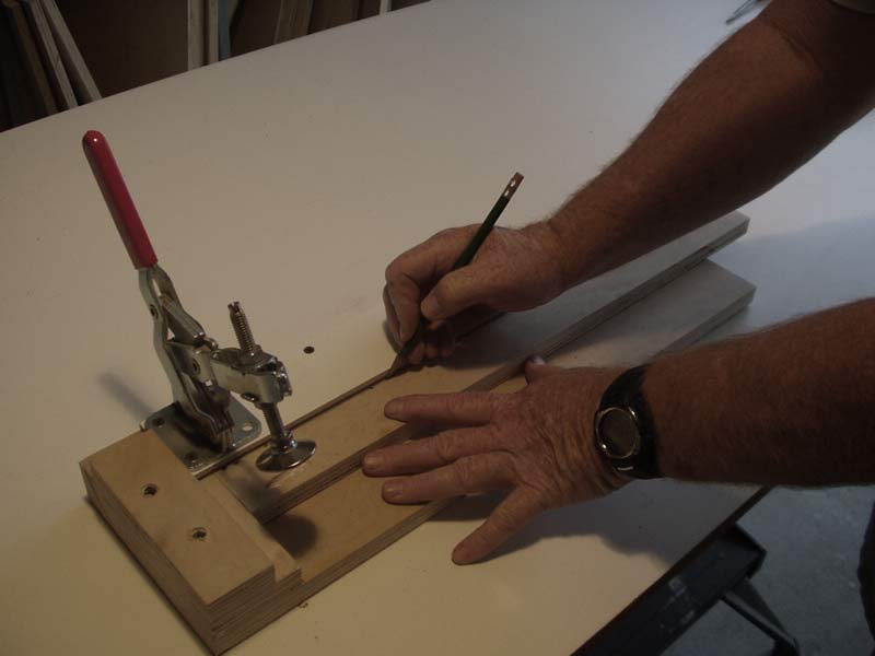

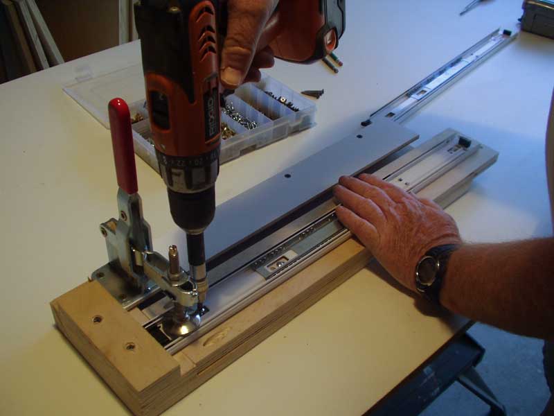

Re: Drw Guides
One more photo of the jig I use for both full ext and euros. The euro side is mounted to the centerline of the frame but attached at the bottom of the opening like normal. With full ext slides I mount the male piece to the centerline of the drawer box. I take the measurement from the bottom of the box to the centerline and then add 1/4", let's say that measurement is 3 1/4". I then measure up from the bottom of the drawer opening 3 1/4" and mark for the centerline of the slide frame. Since I have started using this method I have had perfect sliding drawers almost every time.
- Attachments
- Marking centerline of frame
- sf-marking.jpg (26.89 KiB) Viewed 9385 times
- attaching slide using jig
- P1010008-008.jpg (33.71 KiB) Viewed 9386 times

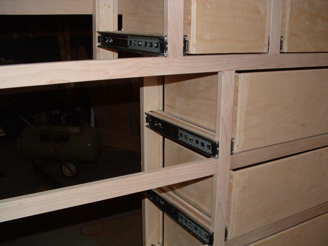

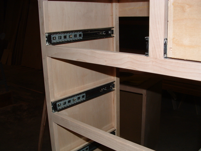

Here are the pictures of my method. Instead of using a solid piece of lumber I used strips of plywood.
- Attachments
- DSCF0003.JPG (137.48 KiB) Viewed 9328 times
- DSCF0002.JPG (120.96 KiB) Viewed 9328 times
- DSCF0001.JPG (134.39 KiB) Viewed 9329 times
