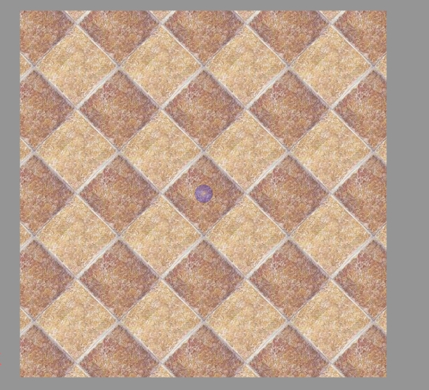

Gary,
There are a couple of images in the STONE directory in eCabinets that are set on a diagonal.

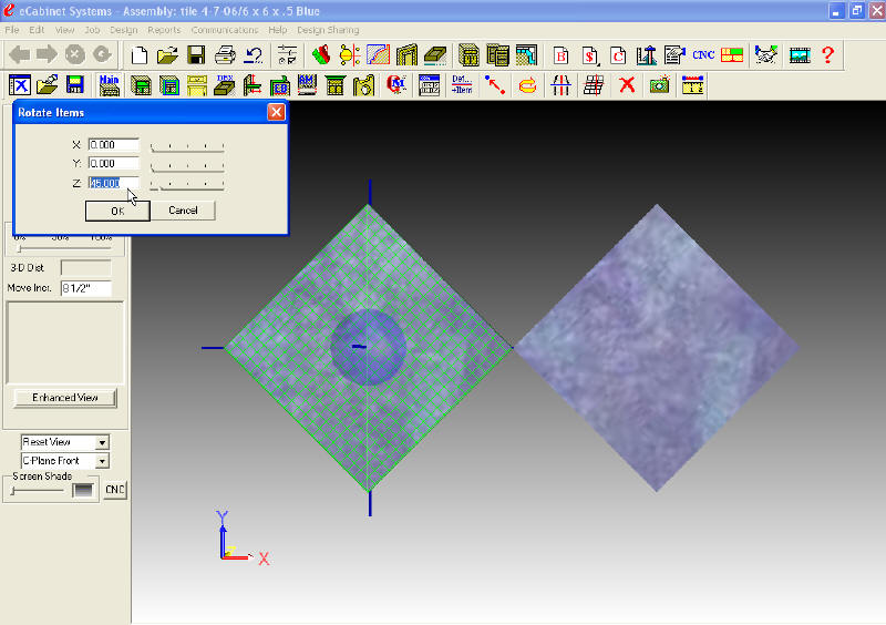

Re: Any ever done this
Gary,
I did this one by creating a display cube and using a square tile pattern then rotated the cube 45 degrees. I then made a jpg of the cube and cropped that in Irfanview back to a ninety degree image. I then used that image on a new cube. You could do this with any tile pattern.

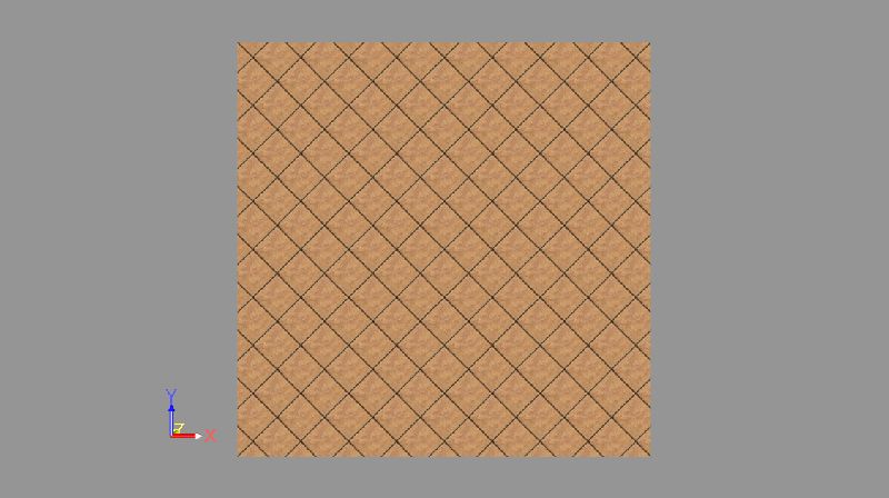

Is this what you are looking for?
- Attachments
- Drift Wood "Tile" at a 45 degree angle with corners "filled" with replicated pattern.
- drift wood 3 45.jpg (7.06 KiB) Viewed 11679 times
Thats it how did you do it?
