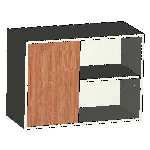

Why use a corner cabinet as the starting point for this cabinet Steve? Use a Std Upper and change the settings to match your needs. Add an up-down stretcher for the return and you're set...like this:
Blind Corner Upper Frameless.jpg (13.49 KiB) Viewed 2835 times
