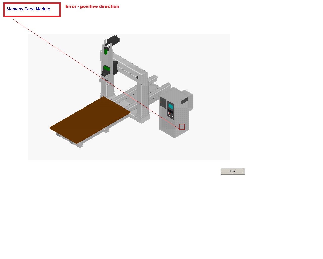

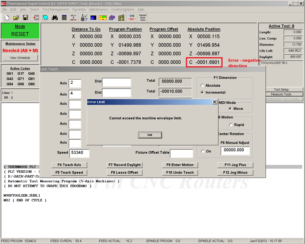

We having C67 Thermwood machine.
In that, I can't able to move the C - axis, at any direction.
While I am trying to moving my C - axis at Positive (+ ve ) Direction it's showing an error of " Siemens feed module "
The same at Negative (- ve ) Direction it's showing "Cannot exceed the machine envelope limit".
Even my tool measuring system also not working due to this issue. It's stacking while rotating the C- axis & showing emergency alarm.
Plz find the attachment's for your References & kindly do this needful help.

First thing to make sure of is that the axis 4 isnt wrapped all the way around in the positive direction and against the positive stop. Also, make sure that you can turn the gearbox pulley by hand with just a little force. If that is good and it is still faulting the Siemens drive, let us know what the error # is on the drive. You can email us directly at service@thermwood.com and we can get this issue resolved. Thanks
