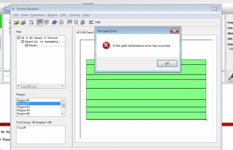

Postby Troy Hollinshead » Wed, Aug 19 2015, 12:37PM
In the Profile Modeler I changed the Regions then hit save and I get the Error.

Postby Thomas strembitsky » Mon, Aug 15 2016, 11:44PM
ive been getting the same error ill post a new thread and hope to get it resolved

Re: File Path Initialization Has Occurred
Postby Larry Epplin » Wed, Aug 17 2016, 10:34AM
You might be missing a file or have a bad file that is needed for this process. Unzip the attachment and place zigaba.twt1 in the following directory.
c:\Profile Modeler\TWD
zigaba.zip
(100.17 KiB) Downloaded 241 times
Thomas strembitsky
Posts: 269
Postby Thomas strembitsky » Wed, Aug 17 2016, 11:15AM
Yeah that file was missing out of that directory and now it works. Curious though as I was missing this file on both my thermwood desktop and the cnc controller. could you check profile modeler and make sure its packed in by default.
