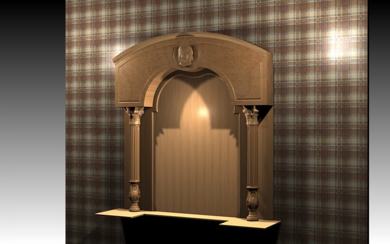

Ok I kind of figured out how to make the turn with the crown mold, now I would like to know how canyou edit a tool because the tool I have is fine it just cuts upside down on the part.
I am trying to make the crown mold turn and return to the wall on the sides

Postby DanEpps » Wed, Dec 03 2008, 6:58PM
You can't edit a tool unless you have the geometry (.x_t) file. If you don't have it, just create the part upside down then the tool will correctly profile the part. :wink:

Postby Damon Nabors » Wed, Dec 03 2008, 11:17PM
Gary,
Loose the plaid wall paper. You have a nice looking mantle but I don't see anything but the wall paper. :P

Postby Gary Puckett » Thu, Dec 04 2008, 12:55AM
Damon Is this better?

Re: Looking for a tool for mitering
Postby DanEpps » Thu, Dec 04 2008, 6:47AM
Gary Puckett wrote:Damon Is this better?
Gary :beer:
C'mon dude,...subtle is in and subtle that is not. :joker:
Postby Gary Puckett » Thu, Dec 04 2008, 8:20AM
OK so my interior decorating skills needs some work :joker: But trying to wrap this darn crown mold around the sides Is driving me crazy and getting the cutter to cut right
