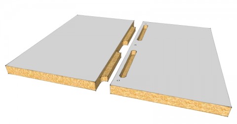

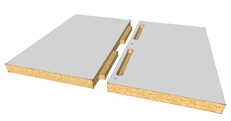

i would like to see a hybrid dado like this. i call it the interrupted dado with option for pilot holes.
Jason, we've talked about this before and i can see that i'm not the only one who would like this. it wouldn't be very hard to do and it would set you apart from all your competitors. just imagine, onsite assembly would become a cinch.

Josh Rayburn
Posts: 1263
Company Name: Halls Edge Inc
Location: Stamford, CT USA
Re: Next Release Question
Post by Josh Rayburn »
Alain,
I'd love to see that too, but I don't want to machine it. That will cut down the life of my tooling on the dado tool and the outline tool significantly. It would also slow sheet times with all that jogging around the outline and with so many additional dado / tenon dado operations.
It's a beautiful joint, no doubt - but what is the benefit to having the tenons split like that versus a long tenon that also incorporates pilot holes right through it at specified intervals?

Posts: 4738
Josh,
the benefit comes from more "meat" to run a screw into and for closets the ability to use RTA fittings in unison with the alignment ease of the blind dado.
I think it would be a fantastic joint.
Josh Rayburn
Posts: 1263
Kerry,
RTA fittings in addition to blind dado would be cool, I hadn't thought of that. Though I love the idea (and picture) of the staggered joint, don't get me wrong - I've been successfully running screws right through the tenons for years and have never had a problem, I guess the real issue for me is that the slowdown in machining time and cutter life is not worth the reward.

Gary Campbell
Posts: 256
Location: Durham NC
Post by Gary Campbell »
Sorry Guys...
If you look at the picture that Alain posted as an example, you arte looking at the very reason the programmers dont allow the Rafix/KDA option and dado to co-exist. Should it be allowed and used for pilot holes, then no problem. All that used it (like myself) would love it. However, should someone actually select the Rafix hole pattern, it would be impossible to assemble. The blind dado insertion requires a movement that is perpendicular to that of the Rafix, and there is no way to perform an insertion with horizontal and vertical motion at the same time.
That said, there is no real reason that it wouldnt work with pilot holes, pocket screw slots and dowel bores. I am sure there are more. Can we as CNC owners and cabinetmakers be entrusted with this power?
Question for Alian.... why do you wish to stop the tenon in the center of the panel for the screw? We have put in thousands of screws into blind dado joints with little or no problem. In fact, the screw helps make sure that the opposite side stays nice and tight as it wedges between the tenon and mortise dado. IMHO, the interuption would increase machining time and decrease bit life. I prefer to keep the bits moving.

Josh Rayburn
Posts: 1263
Hi Gary,
You can get Rafix connectors without the ridge so they can be assembled without pushing them down over the stud, they can just be pushed in straight. Hafele sells them as "with ridge" and "without ridge" for this purpose. I agree with you on the machining and cutter life issues as I stated above.

Posts: 4738
Gary,
The reason for splitting or tabbing the blind dado is for better holding power for the screw without having to use a very long screw and for the RTA fastener in closet applications.
As a customer in production sharing I will care more about getting the joint I want than I will about tool life and machining time. The folks machining the parts would just have to charge accordingly.
For now, where I can such as decks I may use a 100% thickness on my dadoes so I have something to screw to.
