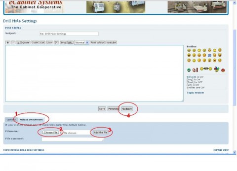

1. You need to use the "upload attachment" tab below.
2. click the "choose file" button and find the cabinet
3. "add file" button
4. submit
-John
4. submit
-John

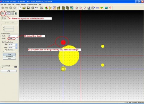

Rob, open up the "hole hardware editor" and bring in the hole pattern. Find out where the holes need to be placed and the depths you want (do this by hovering your mouse over the existing yellow geometry and the settings will be seen). You will need to add in a circle geometry with your proper coordinates and (-) depth setting. Once you enter your coordinates it will ask for the diameter of the hole.Robert Trahan wrote:now just need to figure that out.
I'll try to get to you a modified pattern when I get a chance.
-John

Just pull up the default pattern and double click both holes to highlight red. Then enter your desired depth and hit enter. Save as new name or under existing and your good to go. Make sure you change on all existing cabinets by highlight doors and applying to selected parts.
Forrest
Forrest

Thanks Forest for chiming in! As I was going through the process the way you described occurred to me.
Rob, here is a jpg of the steps.
-John
