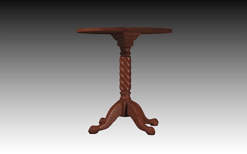

Seems I been having trouble with lighting on my renderings. I guess is I have to put so many lights so you can see the detail that it starts to wash out the walls that surround the item.
I have tried not using so many lights but then you have a very hard time seeing the bottom part of the item. I tried using lights to copy what lighting is actually in the real room and that doesn't work at all. I have tried placing the lights further away from the walls nothing seems to work for me. Here is an example
If you have any ideas I would greatly appreciate them.

Here is a quickie.
Here is a quickie.

I forgot to mention last night that if you want more of the detail under the table top, don't place any lights above it to cast shadows. This is just one light under the top and to the right.

I think you are correct that all lighting effects are down but i think some have a wider beam IE the chandelier.
Nick is correct about using fewer lights, lower intensity.
Be sure to add a shine of no more than 2 to 4 to your walls and floor. You need to add a shine to every texture in your presentation drawing to make it realistic.
Here is a shot with two lights below the table top at right angles with a 30 intensity. I cropped the image to remove the shadows.
If your jpg is too dark, use Gamma correction in Irfanview to correct this.
