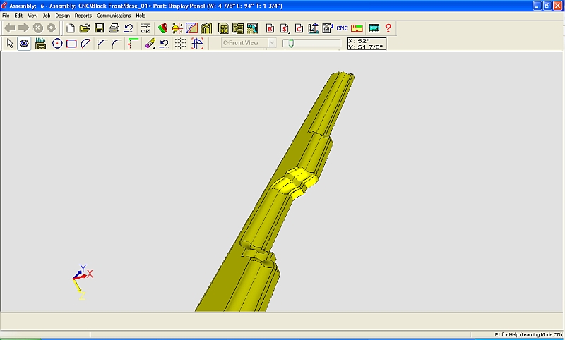

I can get your part to profile to the straight line in the center and it will profile from the other end back to the straight line in the center
I have had a problem with these OG profiles on a complicated part edge similar to yours in the past and Tech support could not resolve the issue They even tried using ArtCam and they could not get it to work

Are you able to create DXF files of the part and profile I have a couple more Ideas but I need the DXFs

Will, I have tried a DXF of a similar shape to Kerry's, and all I could do is the straight sections using Single selection. In Partial selection, I could only select two edges.

Here is the part geometry and tool geometry in .dxf format.

Could I get you to attach the geometry that you used to create the .tol file. { filename.x_t }.

I think if you would add the ability to drill holes for slide mounts in cabinet backs, it would probably fix this problem also.

It looks as if this is not possible using Ecabinet. Are there other Thermwood software options that it will work on? Such as Master Cam or Art Cam

I can't accept that it cannot be done in eCabinets. I can get the part to profile using a chain operation so it should also perform the partial.
I can always use wider stock, profile it as a chain operation and saw off the back side. I would like it to work properly though. Parts like this are what eCabinets has always been about.

Sorry for the delayed response back. I have this on the list to be looked at, especially the chain verses partial chain. I know that if a smaller diameter tool is used, it will perform better. Our 3rd party solids engine seems to not enjoy the tight corners that can cause the tool to wrap back over itself. We have several cases submitted to them in hopes that they are resolved or improved. I will try to keep you informed as I find anything more out on this. Sorry for the inconvenience.

For your information I don't have any luck with smaller diameter tools either.
Using a partial operation I get the Sweep Operation Not Possible error with even a 1/4" diameter tool at 1/8" depth.
It of course works using a chain.

Can you do a partial using this tool? { Amana Tool\AMA-56208-noBEARING.tol } This one works for me. Attach the small .tol file that you used if you don't mind.
