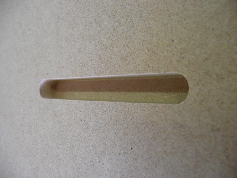

Here's another photo, this is a mortise cut. The arrows are the cut direction.
See how it seems to "whip" as it stops and makes the turn after the end of the slot? As if it accelerated too fast, and then stopped too abruptly, causing the machine to whip. I can see it happening if I watch the leg of the gantry on the X axis (the bearing on the rail), it seems to "bounce" a bit as it stops and changes direction.
Any other ideas? I'm thinking of changing the acceleration number, but not sure what to change it to, higher, lower? I don't even know HOW to change it...

- Scott G Vaal
- Posts: 1740
Re: Machine lash, acceleration, or what?
Jeremy,
You can lower the accelerations by adding in a ramp/acceleration macro. G800 through G809.
G800 is factory settings and each one above drops the acceleration by 10%. So, the G801 will reduce the accels by 10%, the G802 by 20% etc. until G809 by 90%.

- Jeremy Schiffer
- Posts: 1072
- Location: Carnesville, GA
I inserted G803 into the program after the G901 at the beginning. It definitely made a difference, almost totally got rid of the apparent lash. I also tried G805, but it wasn't noticeably different than the 803. I'm still cutting on this job, so tomorrow I'm going to fiddle with it some more, might even try some higher values and see what happens.
Does the G80X command stay active until the machine is reset/homed? What resets it? I'd like to know what to look for so I can make sure it is not being deactivated by another code during the program.

- Scott G Vaal
- Posts: 1740
Jeremy Schiffer wrote:I inserted G803 into the program after the G901 at the beginning. It definitely made a difference, almost totally got rid of the apparent lash. I also tried G805, but it wasn't noticeably different than the 803. I'm still cutting on this job, so tomorrow I'm going to fiddle with it some more, might even try some higher values and see what happens.
Jeremy,
A home will reset this back to factory settings. Also, a G990 will also set this back to factory. The G990 is called at the end of the program and between each sheet. You could use the sheet macros option on the settings dialog to get this added at the top of each sheet automatically for you. You can add the G803 as the header macro and you do not need to turn it off as it will do this automatically in the G990 called at the end.

- Jeremy Schiffer
- Posts: 1072
In CN preferences, I put G803 in the header macro so that it appears at the beginning of every sheet. The machine isn't quite as "jerky" now. I have also slowed the feed rate overall for most materials. Takes longer, but in the end there is less bit deflection, and less machine lash. Mind you, I already ran it slower than a lot of people do, I think. But anyway, I'm happy with it, now.
