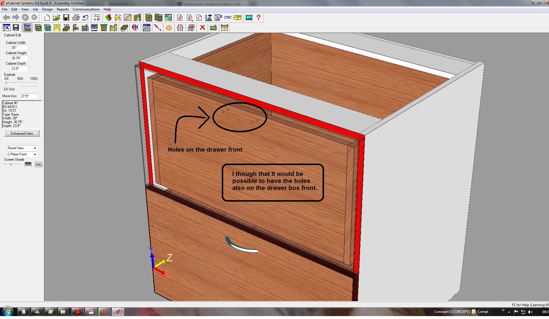

This is what I am doing. I'm trying to add pull holes on a drawer box front that I did associate to a drawer front in the door/drawer editor...

Thanks for your answer. I do know how to ad pull hole on my drawer front. But when I read the new feature for the build 8 it says: Pull hole patterns (drawer fronts and drawer box fronts) ADDED. So I thought that It would ad pull hole on the DRAWER FRONT and on the DRAWER BOX FRONT. I tried with a 1.5" negative thickness and it didn't work. Here is a picture of what I'm doing. So I guess it is impossible to also have the hole on the DRAWER BOX FRONT.

Dennis Englert
Re: Pull Hole
Postby Dennis Englert » Fri, May 25 2012, 9:38AM
Audrey,
Check the Help menu for "Setting Hardware Defaults". There is a section about Applying/Clearing Defaults.
The image I've posted shows the hole pattern on the drawer front and the drawer box front. I think what is missing, since you've probably went through several iterations of trying to get it to work, is the Apply.
If you still don't get it to work, I'd remove the drawer and drawer box, then reinstall it. Then Add the Drawer Pull.
Dennis

Audrey Racine
Posts: 164
Location: Canada, Quebec city
Re: Pull Hole
Postby Audrey Racine » Fri, May 25 2012, 10:30AM
YESSS!!!! I got it! I need to use the negative and the positive thickness!

Audrey Racine
Posts: 164
Re: Pull Hole
Postby Audrey Racine » Mon, May 28 2012, 6:08AM
Hi,
I'll try to explain it to you the best I can.
First: Go in the HARDWARE HOLE EDITOR and create your pull pattern. You will need to add a NEGATIVE and a POSITIVE thickness. The NEGATIVE one for the drawer front and the POSITIVE one for the drawer box front.
Second: Bring your cabinet into the Door/Drawer Editor. In the right panel go to PULLS than DRAWER PULL, select your HOLE PATTERN.
Third: add your drawer and your drawer box. Everything should be ok!
