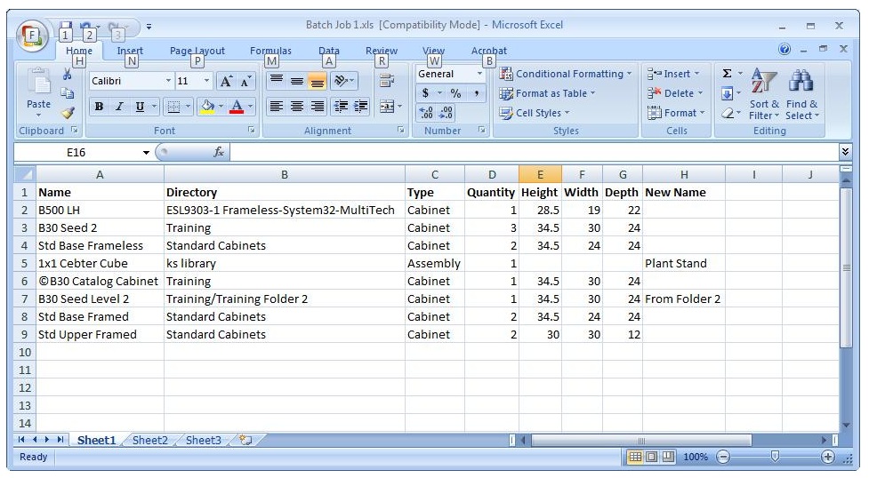

A properly formatted Excel spreadsheet can be used to input cabinets and/or assemblies to the Batch. In the Excel file, provide the file name of the Cabinet or Assembly, the directory where the file is stored, the type ("cabinet" or "assembly"), the quantity of the cabinet or assembly you want and the height, width, & depth if you are loading a cabinet.
Note 1: Line #5 for an assembly. Height, width and depth values are ignored for assemblies, thus are not required. This item and the item on Line #7 demonstrate renaming a product. The new product name is displayed as such in the batch.
Note 2: Line #6 for Catalog Cabinets. Must have the copy write symbol included in the name.
Note 3: Line #7. Displays a path for a cabinet in a sub-folder. By default, the root of the User Data Path is the
folder assigned in Settings and Preferences plus the sub-folder Cabinets or Assembly.
The first row of the spreadsheet must contain column headings that identify the content of the information contained in the column. The file should be saved in .xls format.
The required column headings and format for the data is as follows:
Name - This is the file name of the cabinet or assembly.
Directory - This is the directory where the file is stored.
Type - Use either the word “cabinet” or “assembly”.
Quantity - This is the quantity of the cabinet or assembly desired.
Height - This is the height of the cabinet (does not apply to assemblies).
Width - This is the width of the cabinet (does not apply to assemblies).
Depth - This is the depth of the cabinet (does not apply to assemblies).
New Name - This is an optional field for a new description of the cabinet

I tried again to set-up the speadsheet as you posted. I am still getting the "Error loading row 0". Below is the complete file path and name for a cabinet that I am tring to load.
W:\CNC Cabinets\cabinets\32mm Cabinets-old\Z Prototype\Escape Test\Kitchen Cabinets\BASE CABINETS\B3 13-00-00 1F.hsf
I divided up this name into two parts. Here is how I have things listed in the spreadsheet.
Name column = B3 13-00-00 1F.hsf
Directory = W:\CNC Cabinets\cabinets\32mm Cabinets-old\Z Prototype\Escape Test\Kitchen Cabinets\BASE CABINETS
Type = cabinet
Height = 882
Width = 343
Depth = 604
New Name = {blank}
I have tried taking the name and removing the file extension .hsf (no luck)
I am wondering is there a problem because the file path is located on a server and not on the C:\drive?
Is the directory file path too long?
Is there a problem because the sizes are listed in metric?
Thanks again for any help you can provide.

Brenda Hallman wrote:Name column = B3 13-00-00 1F.hsf
Type = cabinet
Height = 882
Width = 343
Depth = 604
New Name = {blank}
Try:
Name= B3 13-00-00 1F
Directory = 32mm Cabinets-old\Z Prototype\Escape Test\Kitchen Cabinets\BASE CABINETS
Type = Cabinet
Quantity=1
Height = 882mm
Width = 343mm
Depth = 604mm
New Name = {blank}
