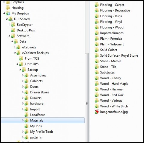

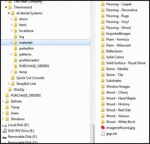

I just did a backup & noticed that it did not include everything in my 'Materials' folder. It's missing 2 folders ('Reflections' and 'Window Images' [and all their contents]) & 1 file ('jpgs.txt'). Can anyone please explain why?
My Materials folder
Backup of Materials folder

The standard cabinets, doors and drawer fronts are linked to specific files from a specific path. If you move or remove those files, then you will get the "texture not found" message or a yellow image tile that looks like construction zone tape or sign. The materials and finishes for these can only be changed from files located in the default paths. The Conestoga Doors and Drawers were previously sold through our online store. The materials and finishes are those that are specifically available through Conestoga and thus are limited to those offerings from those folders. Finishes for other door and drawer types can be selected from any other folder in the Materials dialog, but the material originates from a Generic material for sheet and banding stock.
I advised not to remove the Generic materials for sheet stock, banding stock and banding stock. Also, I mentioned specifically, not removing or relocating the Brewster (wallpaper) folders as removal of the default folders does and has caused problems. The key to the latter is not to remove or rename default folders. I mentioned the Brewster folders as there are a lot of folders that are alphabetically first in the Materials folder and there has been an inclination to move or remove those. Someone in the past did specifically remove or reorganize those folders and it did cause problems. Previously, I hadn't talked to anyone that had entirely changed the folders for the various wood materials, so it did not come to mind during our conversation yesterday and the bulk of our conversation was about backup.
With regards to Backup and Restore. I did a back up a couple of times this morning. My file count results are exactly the same for both backup files. There are several topics on the forum about Backup and Restore. Some suggest that you only need to do a partial backup for sake of expediency. In any case, I believe that if the Backup Settings are consistent between the two computers, your results will be consistent. I don't have any idea why the Window Images folder would be missing as you've shown, but if your results are from the two computers, I'd double check the settings. I'll continue to test this.
