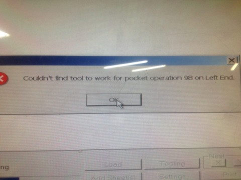

Ive done something similar and now it gets stuck on couldn't find tool for pocket operation. nothing loads

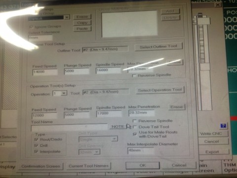

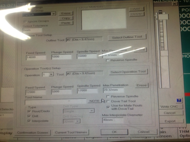

You will need to check the tooling section to make sure you have tools selected for pocketing. Also make sure that there is NO name in the name field. THis is used for specific softwares and Cn will ignore any tool with a name unless it is reading from these files. Next make sure that your pocket clean up amount is not too large that it cannot fit the tool in the pocket. If the pocket is only .4 wide and you have a cleanup of .1, then you will only have a area .2 for pocketing before the cleanup.

Is there any way to retrieve the tool settings from previous settings? I might have erased all the tools witht the erase button now Im unsure of which ones to put back in. Im only using a 10mm Triple flute cutter as an outline tool and same as for any dado or pocketing. The Drill banks are also used.
I tried to enter only the 10mm in and the drill banks but still come up with the problem.

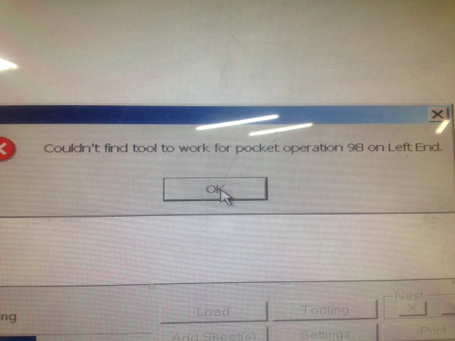

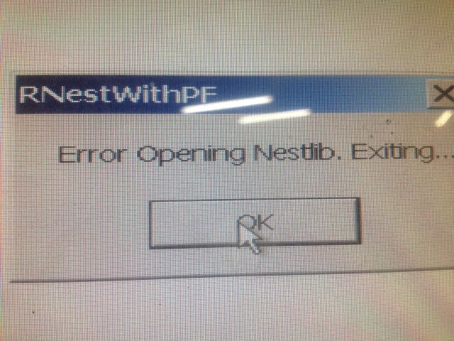

Every time I go to nest I get Couldn't find tool to work for pocket operation "#" on left end , top end etc. This is up to 400 times before it ends in either an incomplete looking nest, or another error once pocketing has been finished saying Error Opening Nestlib. Exiting...
