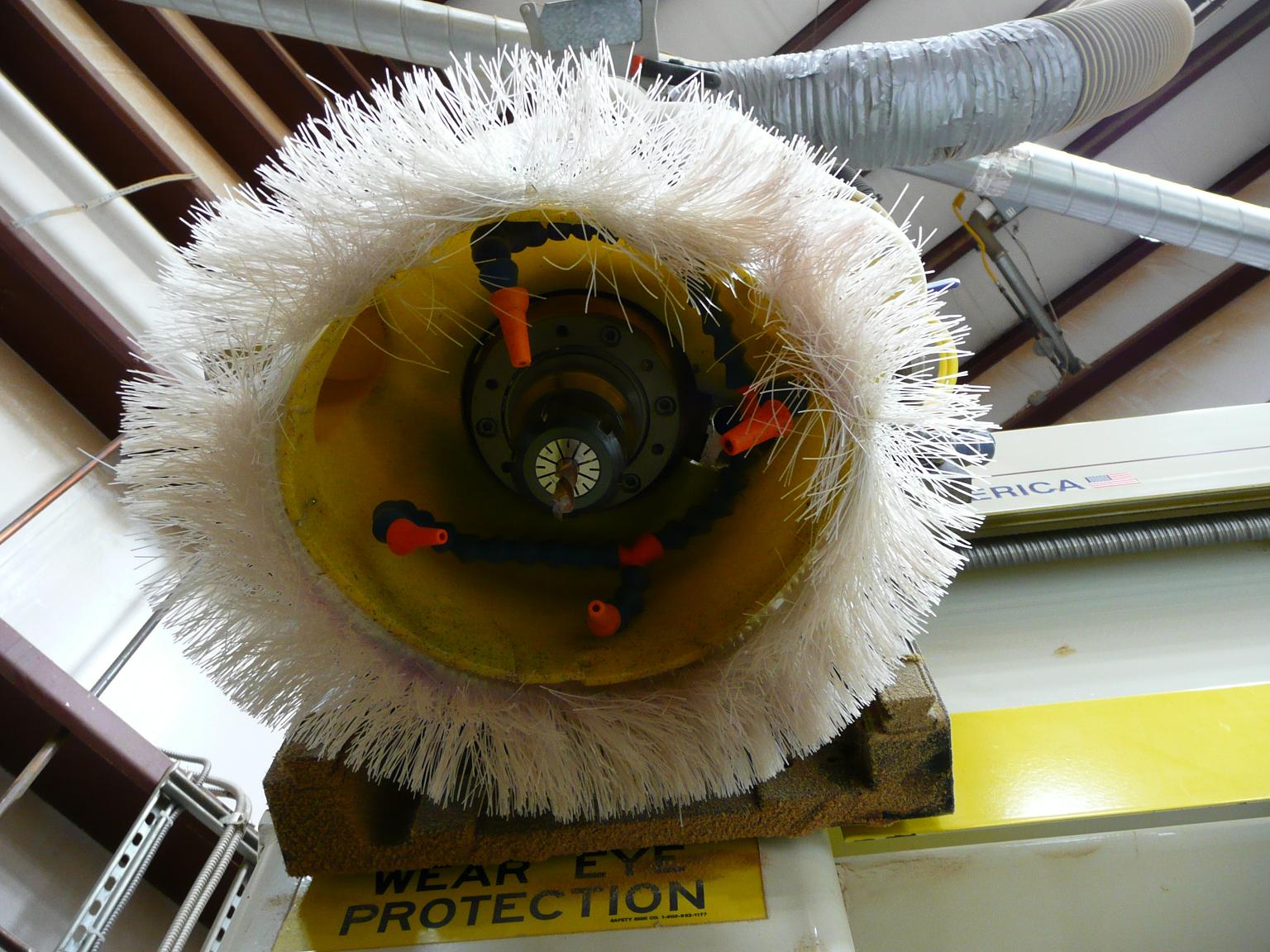

We finally replaced that clear plastic strip that came with the machine, after 6 years of use. We bought the brush strip that THM sells. It's pretty nice and we can't find it any where else. We also bought some of that flex-lock coolant hose from MC. Mounted a ball valve on the spindle plate and have 4 nozzles aimed at the bit, one on each side. I believe it also helps to cool the bit, but that might be wishful thinking. Anyway, we now measure our dust in tablespoons.

Sounds COOL!!!(pun intended) What is your CNC Model? Do you have an ATC on table or on head? Mine is a C40 with both tooling on table and on the head. How did you get yours to work? Pictures are worth a 1000 words or more. I would be concerned about the nozzles getting moved around by debris it may pick up and then interfering with the ATC. Is it an issue for you?

We use a CS40 with ATC on table. So far, no interference from nozzles. Will try to get pics tomorrow.

Postby Dave Burtchell » Thu, Nov 29 2012, 6:30PM
Here are a couple pics of the air nozzles. Our operator says they DO get knocked around by debris, but are easy to realign. We're thinking of making a ring that could be wire tied to the perimeter of the hood with a quick disconnect so the hood can be removed easier.
Any way, it works great for now. keeps the chips air born and the kerf clean.
