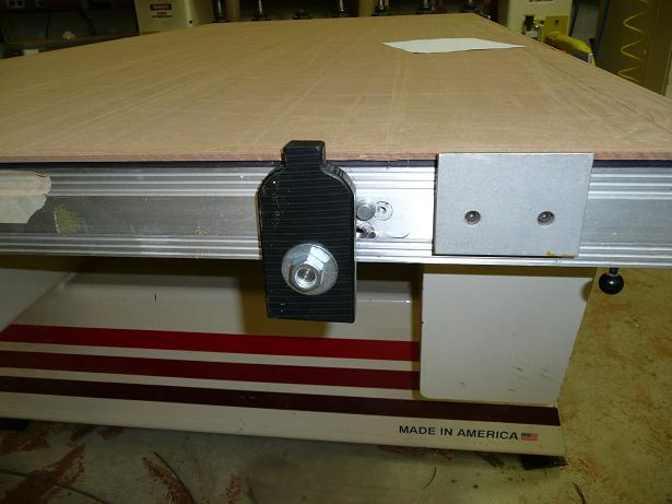

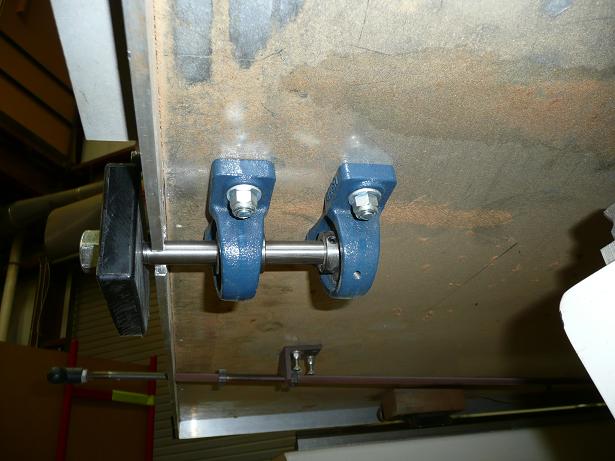

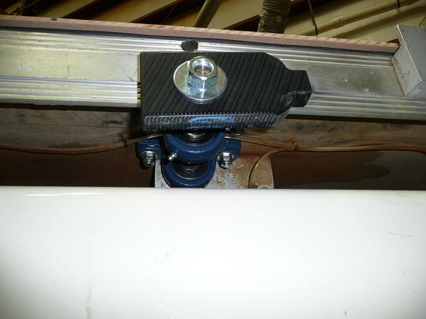

Postby Dave Burtchell » Fri, Oct 25 2013, 11:51AM
Went ahead and bought some cheap 5/8 pillow blocks from Ebay. $5 each. Some military surplus shafts with 5/8 threaded ends. Another $30. Already had some 3/4 Delrin. About $100 all told with mounting hardware. took all day. Threaded the delrin so I could fine tune the position.
So far they work great!
Here are some pics.
