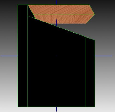

Still new to ecabs and am trying to make this cabinet with the lid closed any help?

Use a Rotated Stretcher

That did the trick.
Thanks Very Much
