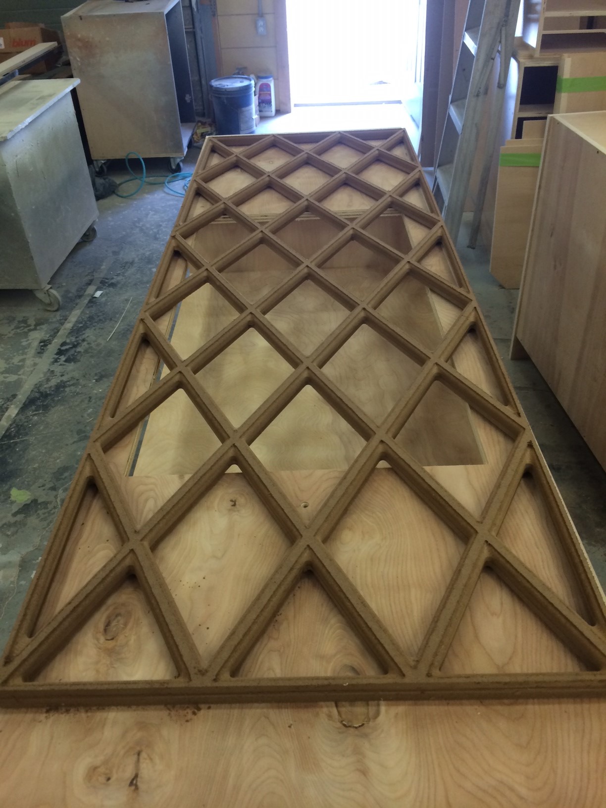

I'm cutting a panel with lots of pocket cuts on it and i want it to cut most of it with a bigger bit then the 1/8 to clean the corners up. i wondering if this is possible.
Squared all corners after.

What program are you trying to design it in? Ecabinets? Or are you just using dxf importing?

Postby Griffin OHara » Tue, Jul 08 2014, 2:22PM
I'm using eCabinets

Have you considered trying it with a layered .dxf file instead?
