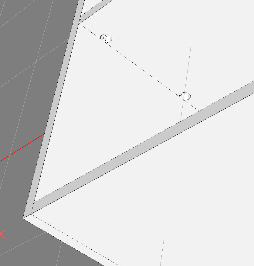

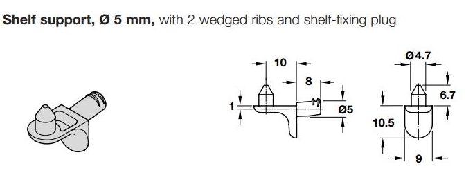

Is it possible to have adjustable shelves drilled on the bottom face for this shelf pin? If so, could you please tell me how? Thank you.

Thanks for your reply Forrest, but I need something a wee-bit less time consuming and a whole lot more dynamic than that I'm afraid. I'm not interested in creating 4 statically located holes on each a/s manually. They need to dynamically align with the holes in the gables (in/out).
Is there any way to do this with KD fittings?

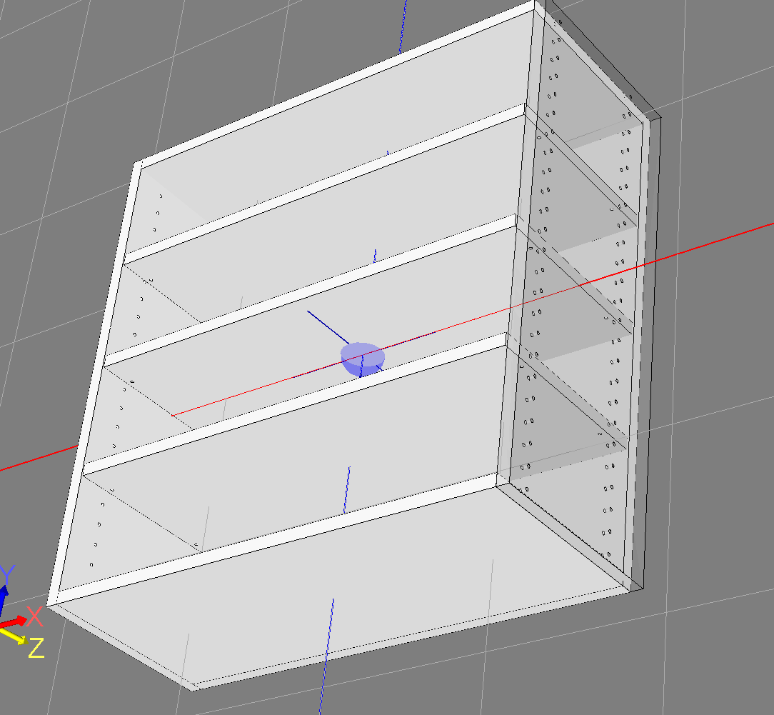

Use a fixed shelf, set the left and right insets to 1/8" or however much clearance you need to clear the shelf pins. Set the joinery to KD/RTA for the shelf, and you will need to modify or create a new KD/RTA hole pattern that matches what you need.
See the attached picture. You would change the large hole in this pattern to 5mm. I would think that you could probably even have extra holes in the hole pattern to create a row of adjustable shelf holes.

Add a phantom adjustable shelf with the required number of shelf holes up, and zero down. Or vice-versa. Then you are free to add as many "fixed" shelves as you wish, and each one will already have the holes in it. It really couldn't be simpler, unless a specific option in the shelf editor was added to accommodate these kinds of shelf pins.

I knew if I spouted something about using a KD pattern that the smarties like Jeremy would come out with the process.
Hopefully the extra holes in the modified KD pattern (2 above and 2 below) will work.
With a "phantom shelf" adding the line boring, you would have to make sure the positioning was maintained (by also adjusting the "phantom" adjustable shelf) if the hybrid (fixed with KD) shelf depth changed. With the fixed shelf/KD solution, the related operations shift automatically since the pattern is all linked.
The only thing I can see as causing an issue will be that -
Since (if I am not mistaken) a fixed shelf defines a "opening", you will have to define the doors FIRST and then added these fixed/adjustable hybrid shelves afterwards.
** I think that we had suggested a while ago that perhaps an option could be made that if a fixed shelf had a front inset, that it would then NOT be considered as defining an opening. (Might be an idea for the 6.1 release??? :wink:)
