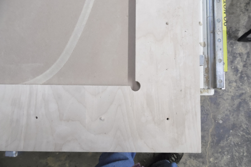

Hi Will, I thought about something just like that. I do have the aluminum one that came with machine, but it can still be inaccurate. Please post a picture of your fixture in use so I know I am on the same page.THANKS

Re: Flips not lining up?
Postby Will Williamson » Thu, Aug 20 2015, 3:01PM
Hi Mike
I,m out of town right now I will email you early next week.
In addition I use dowels to locate the square. As I was putting a 1/2 inch circle in the inside corner for sawdust.
I realized that this X,Y would be my new G902 location. That worked so good I changed my G901 to the same location as my G902'
Never had another miss cut.
Will

Will Williamson
Posts: 403
Location: Capac MI
Postby Will Williamson » Wed, Aug 26 2015, 7:40PM
Here are the pictures
Will
http://www.willmade.com

We have been directing our clients to use a "flip fence" exactly like that for almost 20 years. It was necessary to perform back machining operations for mullion doors produced with Panelmetrix.
We currently provide our clients with a small program that will allow them to create a "flip fence" when ever needed - like when one gets lost, damaged, etc.
