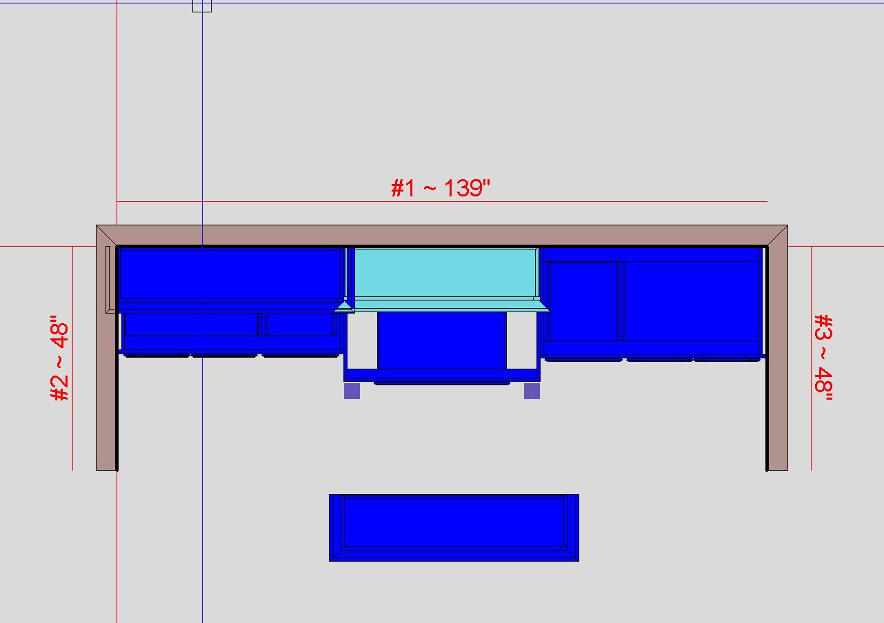

Here you can see the one top floating.

One other problem I am having is that when I go to the construct countertop page one of my base cabinets appear not to be against the wall. But, as you can see when I go back to the plan view and move the wall unit out of the way it is actually against the wall. I've never had this problem before and I'm sure it is something simple. Thanks.

If you select the top you should be able to move it down.
The only way I can think it installed this way is if you have 2 base cabinets next to each other and they are not the same height, when you create the top it will ask you what height to install at.
