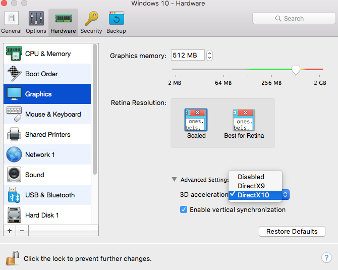

I tried un installing and re-installing Parallels Tools and there was no change. I added a screenshot of my available selections for 3D Acceleration. Do you have any ideas?
Thanks again for your help.
Bill

I think it should be directx 10 since it is windows 10. Can you make sure that parallels is using the discrete video card?

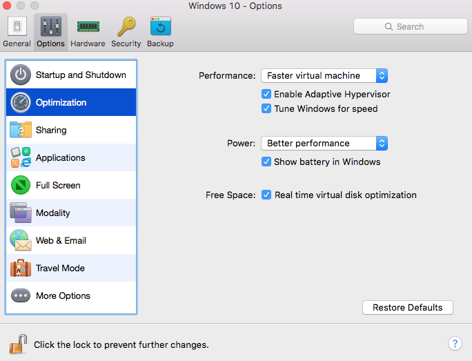

To switch between the adapters, go to virtual machine configuration window -> Options -> Optimization - Power
For integrated graphics (CPU) set 'Longer battery life'
For discrete video card set 'Better performance'

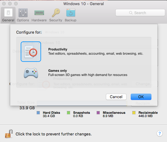

Another thing to try is swapping to Games Only or Design Profile.

Postby Bill Ward » Fri, Oct 30 2015, 3:26PM
Thanks for the ideas. Good to know about switching between the integrated and discrete video cards.
I did have it set to 'Better Performance' so it should be using the discrete. I get the exact same performance no matter if it is set to 'Longer Battery Life' of 'Better Performance'. That is, if 3D Acceleration is disabled, it will draw but extremely slow. With either DiscreteX enabled, it does not draw at all.
I also tried the gaming mode which didn't change the way eCabinets performs.
Interestingly, there no longer seems to be a 'Design' profile.
Any other ideas?
