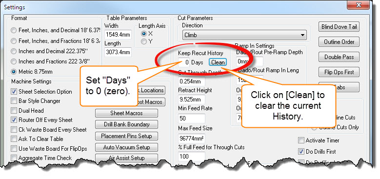

I am not sure if it has been suggested yet, but...
If you are NOT using the "Recut" feature, set the "Keep Recut History" to 0 days and [Clean] the existing History file. The behind the scenes management of this HISTORY database as well as its growing size can slow things down.
It should be noted that after you load a TWD and you perform a [Nest X] or [Nest Y], Control Nesting adds the "new" information to the "Recut History" even if the job is not written to CNC.

hi brad,
if we need to recut parts we simply reload the program again. so by what your saying we would have alot of those files there as since ive been here ive not known about the recut option or files. so deleting those files as you said would make a difference as there would be quite literally 100s of them.
what are the steps that are required to clear them?

Chris,
In the Control Nesting [Settings] dialog, set the "Keep Recut History" to 0 days and [Clean] the existing History file.

hi brad,
cool thank you for that information, i will set that and see how it operates. if im correct that there is lots there it should be alot better.
thanks again
thanks again

ok we have some good news, the cnc is loading jobs remarkably faster than it was.
thanks to all of you guys. your help has been much appreciated
