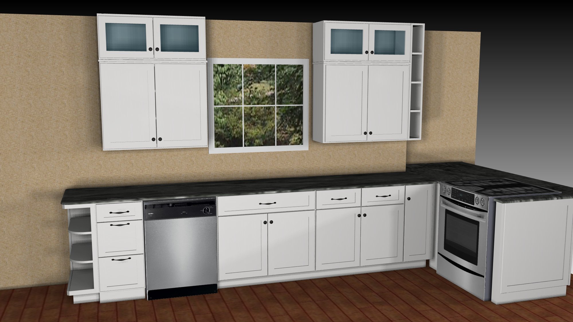

I do alot of White lacquer work and I ended up using the hard maple whiteivory40sheen for all my White renderings, seems to work and the customers like the presentation.
Leo Graywacz
Posts: 572
Location: Windsor Locks, CT
Re: Repetitive graining in renderings
Postby Leo Graywacz » Tue, Feb 23 2016, 5:02PM
Looks better then just plain white. There is still fading in the upper section of the door. Much better then most of the panel being washed out like mine though. :beer:
