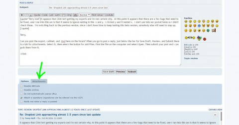

Can you post the export, cabinet, and .twd here on the forum? When you go to post a reply, just below the bar for Save Draft, Preview, and Submit there is a tab for Attachments. Select it, then select the button for Add Files. Find the file on the computer and select Open. Then submit your post and I can grab them from it.
