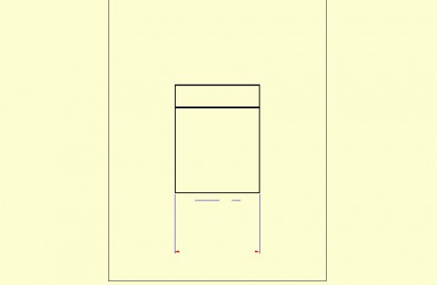

When I bring a cabinet into the line drawing portion I no longer get numbers? I get the carrot ends, I get the circles to designate the corners, line expansion but NO dimensions. anybody else ever have this problem? I even re installed latest update but problem still remains. :?:

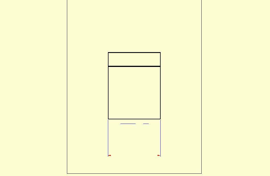

Just tried LDE this morning. Same problem. Thought it might be a Windows update problem so I downloaded the latest video drive from Nvidia. Same problem. Drawings that I did several weeks ago and new drawings don't display the numbers. Extension lines and arrows are OK. The dimension lines are set way toward the object that is dimensioned. Line enhance does not seem to help.

To me it looks like the cabinets are coming into the line drawing editor in "Perspective View" for some reason. Haven't found a way to correct this yet. A slight work around is to bring the cabinet into line drawing editor. create a dimension (it won't show up). Then right click and hit "reset view". The view will be reset to orthographic and the dimensions will now work. Hopefully that works for others. Please fix this eCabinets!
