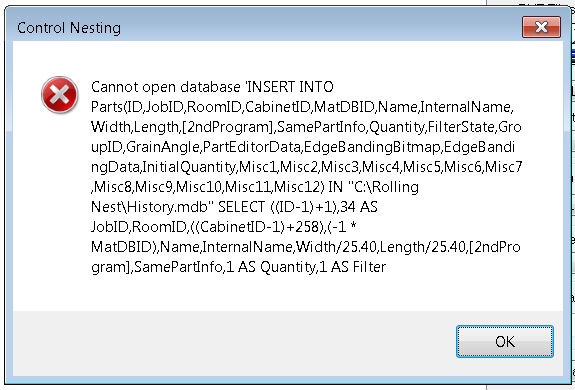

Just to update...
I ran the latest Control Nesting update, and those error messages seem to have disappeared... to be replaced with a brand new one
this comes up when you select a .twd to "load", but not if you select a .twd to "add"
then it comes up again when you try to nest the job, and you have to cancel out of the nesting process. But then when you try to nest again, it works fine.
This happens with old jobs as well as new ones. That error message also pops up when you try to "clear all" in the job entry screen.
So we now have an awkward way of working around it, but obviously not working the way it should.
Any advice is welcome :?

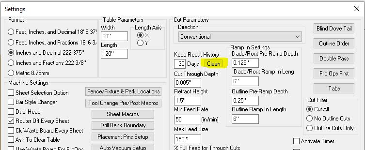

Clint Buechlein
Posts: 787
Company Name: Thermwood Corp
Re: Nesting Errors
Post by Clint Buechlein »
You can try going into Settings of Control Nesting and choosing the Clean button. That may get it corrected. See screenshot below.
