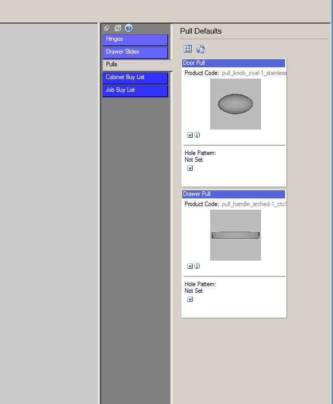

OK, guess I'm clueless. I just can't seem to figure out how to get them to work. I've downloaded the knob/pull library. I have a cabinet in the editor, I've selected a pull, I've made a hole pattern and neither will apply.
Anyone want to walk through the steps for me please?

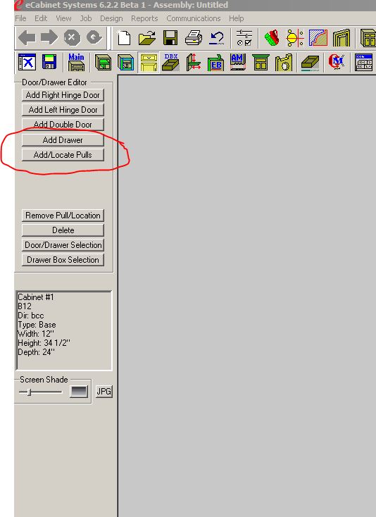

Ok, so you have selected your knob or pull
now just click the add button and a dialog box will pop up so you can locate them where you want
the hole pattern is for when you machine the doors or drawer fronts you can have the holes drilled
Tim

OK, didn't realize it needed to be done in that editor.
But now the pull I selected doesn't have a 3D representation and doesn't show. Whatta bummer. I've tried 3 different pulls and knobs and none show. Very disappointing.

It does have the latest updates. I make sure of that constantly. eCabs said there was no 3D file for the pull.
