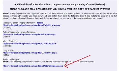

Hi,
I just installed the :
Additional Images:
NOTE: The following link provides an install that will add additional images for use in eCabinet Systems
From the web site. My wall is fine but I cannot generate the view... see picture.
Additional Images:
