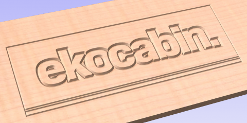

It would help if you had a better image of the logo. The best would be an image in the .eps format. (encapsulated post script)
This will help to have clean edges to detect and create a .dxf.
The edges are too ragged from your small image

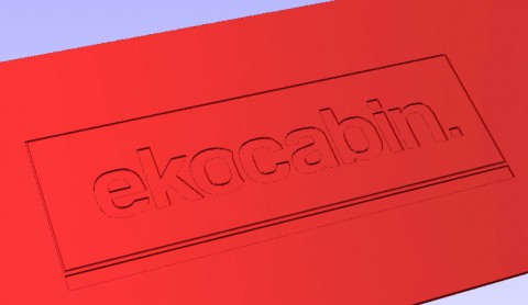

Post by Brad McIntosh »
I did this in Vectric VCarve Pro in about 5 minutes.
  • Imported the raster image.
  • Traced the raster image.
  • Quickly fixed up the vectors. (Could use a little more "massaging".)
  • Defined a "Profile" tool path with "square corners".
