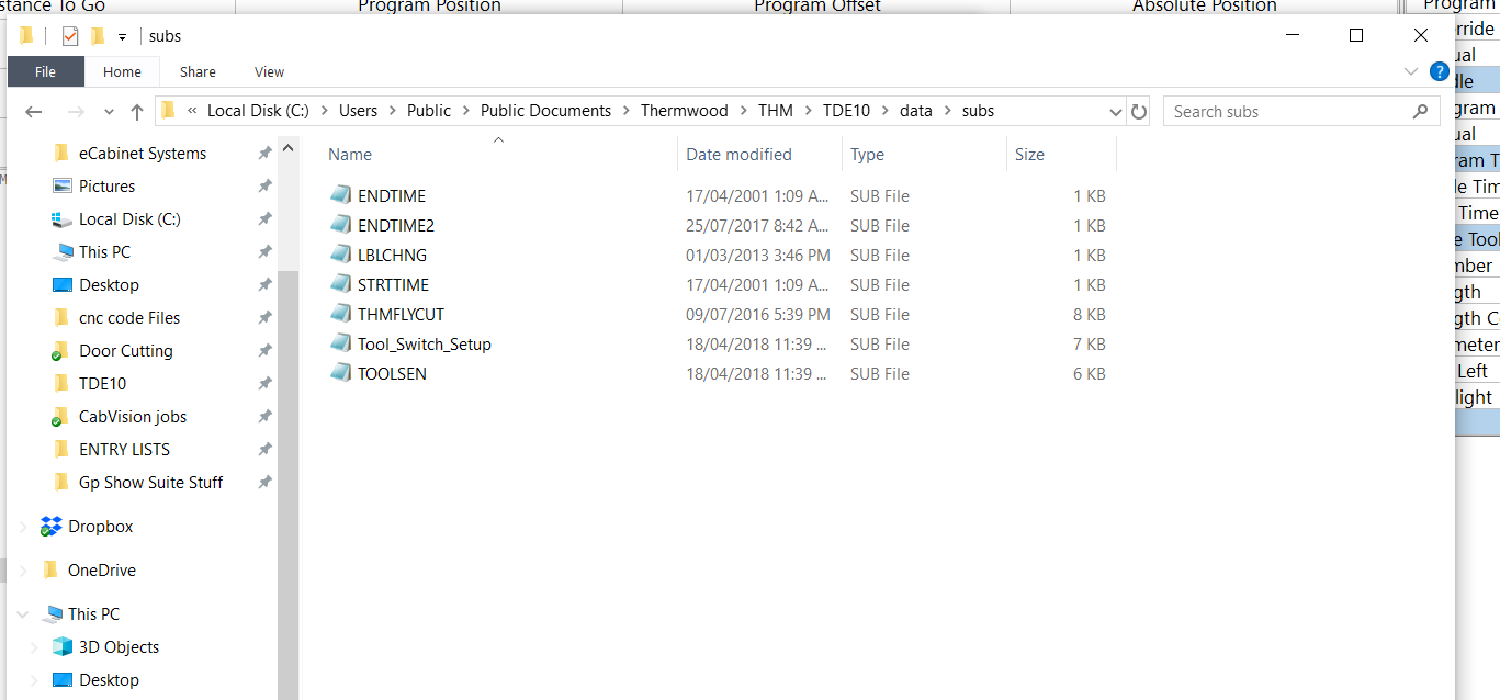

you have to import your sub routines from the physical cnc. that the only way I got it to work cause for whatever reason thm desktop doesn't ship with them.
the file path is C:\Users\Public\Documents\Thermwood\THM\TDE10\data\subs

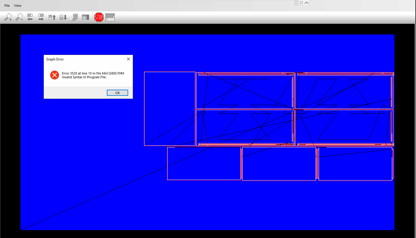

Still a no go. Here is a screenshot of the error I get when I comment out the offending line of code or change retract height in control nesting to 0.
