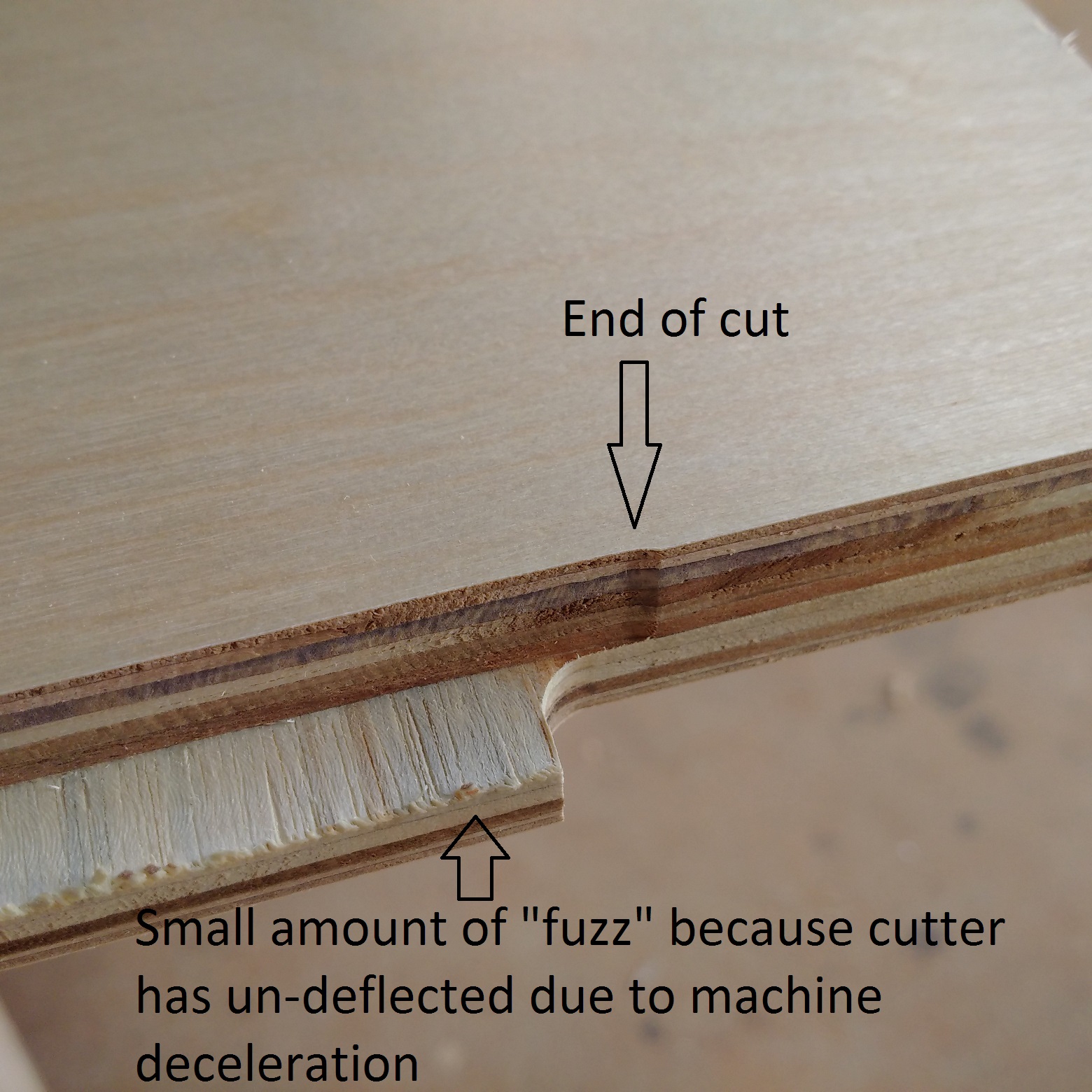

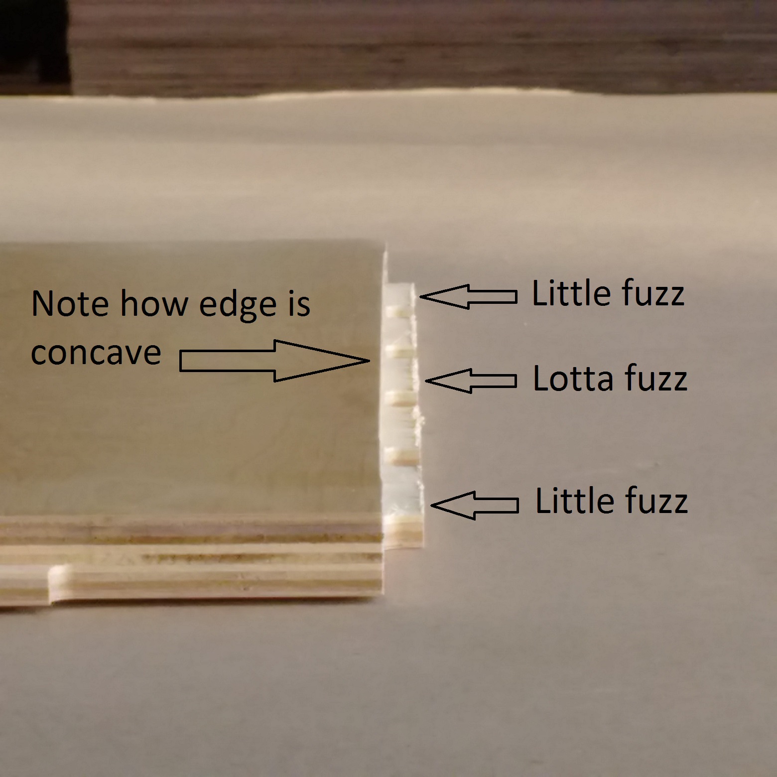

I'm attaching a picture to show what I'm talking about - this causes a gap in the assembled pieces because the Single-Pass Tenon cut is not actually straight, but arcs inward and the back outward as the machine ramps up and then back down during the cut.
If the Single Pass Tenon cut could do a climb first so as to deflect away from the part, then conventional to clean it up, that would fix this issue and make me a very happy camper. Thanks!

Jeremy,Jeremy Schiffer wrote:The addition of the ability to have the preliminary outline cuts as climb, with final pass conventional, was a real lifesaver and cut quality improvement. Would it be possible to implement the same strategy for the Single-Pass Tenon Cuts? As it is, they are done in a Conventional cut direction, and when the part is then outlined, there is always a ridge (between the lock dado tenons) caused by deflection (of what? That is another rabbit hole...)
Can you post a picture of the whole edge being cut on single pass so I can see the entry location as well? Do you see this on both your 45 and 41? And some questions about the tool that is doing the work: Manufacturer, part number, spindle speed, and feed speed?
