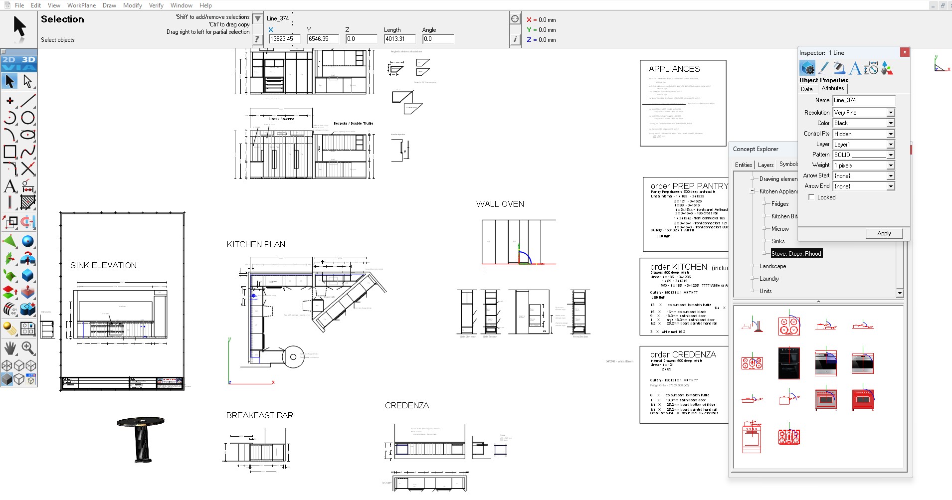

I have attached a screen shot of the sort of drawings we do. That one is one of a more detailed type of job, but we do at least a floor plan and one or two elevations generally.
Everything is drawn in one to one size. We just drag a border around the parts we want to Print or save as PDF, or turn into Jpegs to put into PDF page format in another program like MS word or one of those PDF creating programs.

The attached picture was exported from eCabs and dimensioned in Viacad
Hope that helps

Been working on this today, My drawing looks like yours. Cabinets have that reddish haze while the dimension lines are a sharp crisp black. When I go to print I only get the dimension lines? Am I missing something? I have been through the menu & can not find anything that would change these lines to make them printable. I tried to take the image and convert to PDF using PDF24 but it would not accept the drawing & ViaCad does not allow me to save as a .DXF or any other type of file.

Got It. Had to make a border that was 8X11 copied & pasted cabinets they were HUGE compared to border Scaled the cabinets to a .10 to fit inside border and good to go.
