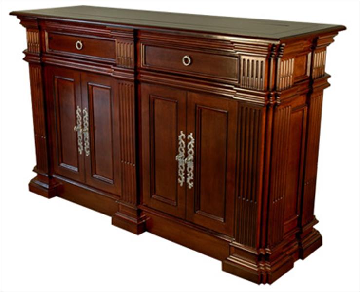

Dont know if any of you have followed up on the original discussion thread, but here is some additional "market info". I have been asked to build a pop-up TV cabinet (with flanking wall cabs & bookcases) so I went looking for cabinet designs and TV lift gear.
1- I found TV lifts ranging from aprox $500 to $3000 for units that seem to perform the same basic function.
2- The Whisper Ride lift available thru eCab is about the least expensive, but I'm always wary of that. What does it NOT have or do that the others do ? For example:" will it power-off the TV when it lowers into the cabinet ? I would see that feature as a real benefit.
3- Someone at Thermwood said (almost 2 years ago) they used the Whisper Ride lift there and it was fine. Any further comments on serviceability or functionality ?
4- Kerry, Dan, et.al., did any of you ever build/sell the credenza ? and if you dont mind saying, what did it cost to build, and what did it sell for?
5- Finally, in my online search for cab designs and lift suppliers I came across several selling both. This one looks remarkably similar to the Italian Renaissance. It includes a lift. The price range quoted "depending on dimensions, finish, etc, etc, etc" is $7900 to $11500. Maybe some of you know who it is. I wont ref the website here as I don't want to advertise for them - I'd rather build and sell them myself - but if anyone wants to know email me and I'll tell you. Don't know if the "seller" is a Thermwood client of if they use one either.
Kerry - to refer back to your original question - I hope you did get to build this thing, and if you did and sold it, I hope you sold it at a REASONABLE profit. But I have to vote with the fellow who first said $8000. From what I've seen for sale anything much less would be a candidate for a big-time charity tax deduction on your 1040.

The attachment is one I found online
Greenwich Buffet.jpg (47.23 KiB) Viewed 55852 times
